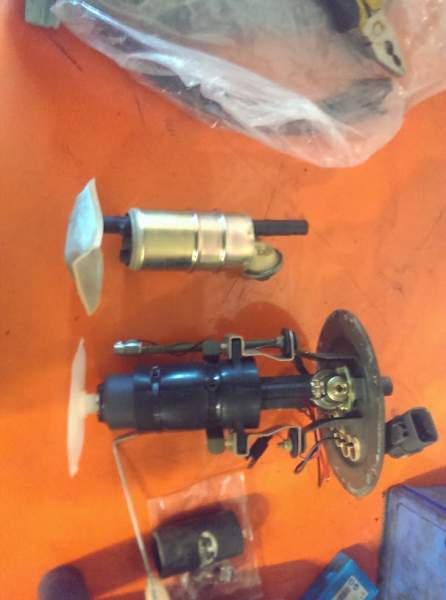

does this pump bolt rite in or is there mods to do to fit it? what I the max power limit in the z it can be used to 600bhp 700bhp 800bhp ?
Pretty much a straight fit. It's much smaller than the original pump.

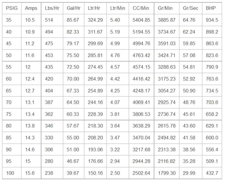

Make: AEM High-Flow 320 LPH
Pump: 50-1000
Volts: 13.5
Test Fluid S/G: 0.76
Fluid Temp: 69
AEM might be considered a newbie to the fuel pump market but don't let their adolescence fool you. The newest fuel pump to the AEM lineup is rated at 320 lph at 43 psi and is a direct drop-in unit that can be used for both naturally aspirated and forced induction vehicles. Upon testing the unit, we found the pump to offer rock-solid voltage fuel flow stability throughout the entire test, which was a common problem among the cheaper "knockoff" models we had tested in part one.
