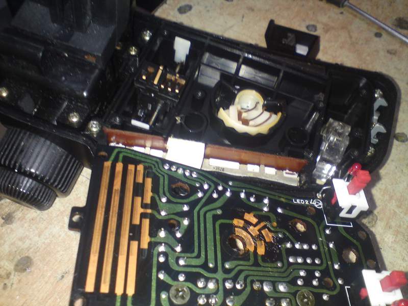

I sent my pod away a few years back and when it came back the contacts in the slide switch weren't just put back correctly.
It sounds like the same thing, check them and re assemble :cool3:.

I've taken the pod out and undone all the screws but the back plate is still held in place, I'm guessing there's a plastic clip in there somewhere. Do you remember whether it needs to be pulled out at one side or in a certain direction? I don't want to force it and snap something! Cheers

Ok that's totally different to how I imagined it would come apart, I'm glad I asked!! I'll have a go at that this weekend.
When you say to pop the two switches off, you mean just pull them from the front? It looks like they just push onto the red plungers?

Yes the red plungers are the actual switches, either pull the outer switches off first from the front or even just pulling the board up will make these fall out.

That's great thanks. I'll have a pop this weekend. I'll be straightening my slightly wonky steering wheel so that gives me a job to do while waiting for 20 minutes between disconnecting the battery and removing the airbag :)
I took the pod apart on Sunday. Connectors looked ok but they were a bit grubby so I cleaned them up, and so far no clicking! Thanks for a really helpful post, removing the board was very fiddly and it helped to know for sure it was meant to come off that way without breaking!
