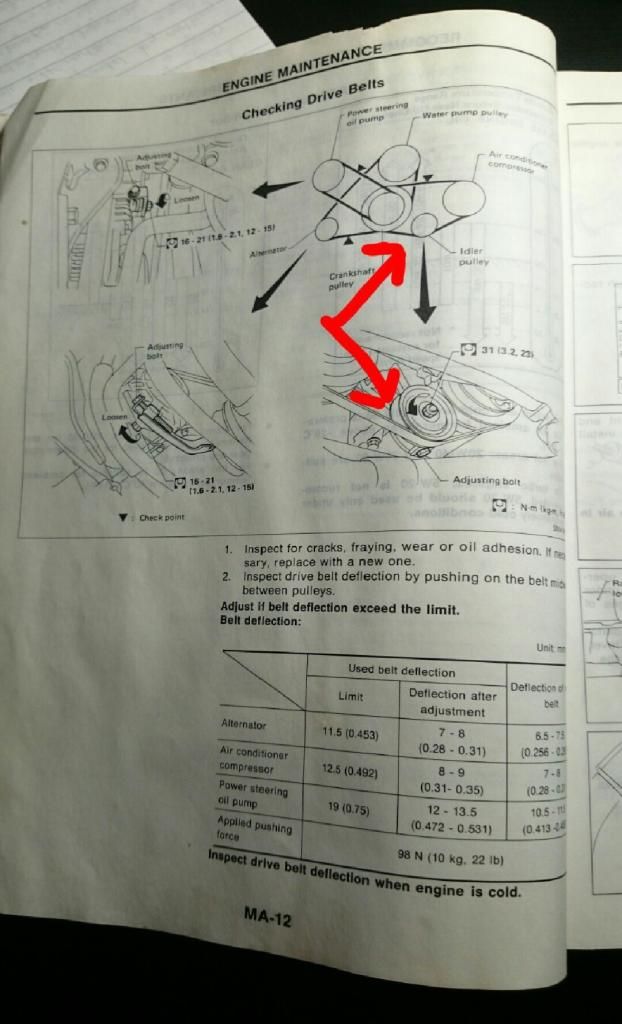

I was wondering if someone can point me in the right direction to find an ac compressor idler pulley , as I believe mine has a worn bearing causing it to chew up my belt a tad
