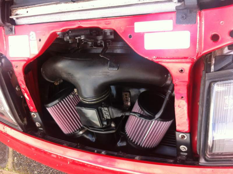

This is what I have on my zed I had it fully serviced last year and I bought two K&N air filters.
Ok, a dual intake splits the intake completely. Separate air flow to each turbo. The Y-shaped item you posted is a single intake. The picture in the post above is a single intake. It just has an adaptor with two filters.

Hi Noz, is it better than having two on or just the same as having one on and is there much benefits in having two than one filter?
Having two filters before one MAF is the same as having one large filter (with equal surface area) before one MAF.
So really having two filters hasn't made much difference so was it pointless of the previous owner before me doing that mod
That kind of set up is more due to space limitations & design considerations than anything else. It's a Zed, so everything is twice the price :D
If you have a big filter (eg HKS mushroom) jammed in down there facing the front of the car, you can end up having low speed drivability issues. Depending on the wind direction, throttle position, engine load and vehicle speed, the MAF element can be affected by turbulence and under certain situations it will read too high a voltage, resulting in very rich fuelling. I experienced this when I had my MAF & filter behind the near side indicator. Once I blocked off the bumper slats & relocated the MAF to the engine bay, it was fine.
With the set up you have, you won't get any of those issues, as air cannot enter the MAF without being drawn through due to the requirements of the engine. Also, the air filter surface area needs to be sufficiently big for 300+bhp of air.
