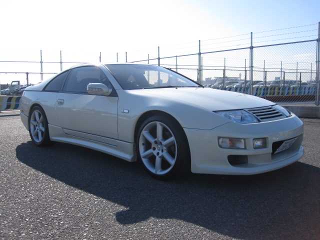

my z in Japan

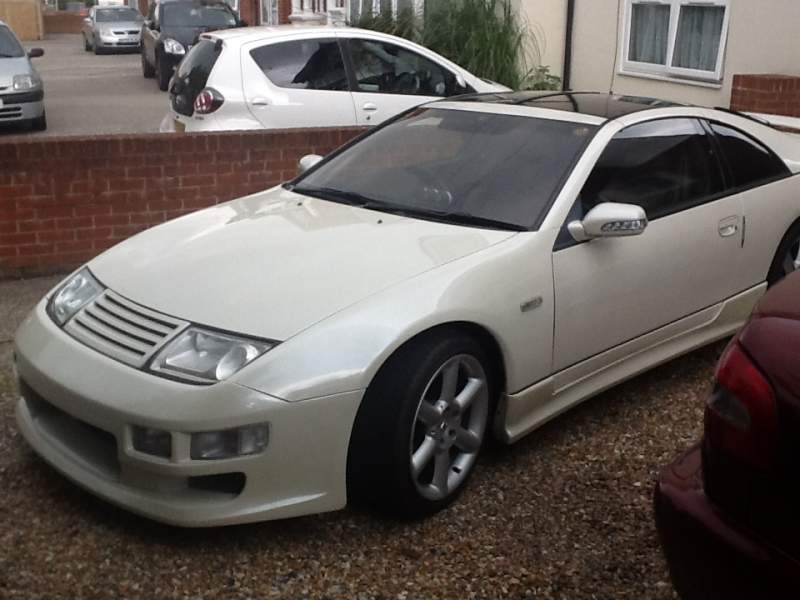

One week after import (10 weeks later!)

my z in Japan
[ATTACH=CONFIG]84647[/ATTACH]
[ATTACH=CONFIG]84648[/ATTACH]
