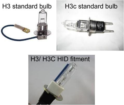

The picture below shows the difference between the bulbs, as you said the zenon / hid ones have leads on the bulb, this connects to the ballasts and the power lead goes to the standard connector on your zed so all plug and play.
Hope that helps
Jeff
okay Jeff, thanks so far. So I'm right in assuming the H3's flying lead plugs into the 2 pin socket, obviously into the power, if this is the case can a H1 bulb , which has only 1 blade be used, with the power socket of the plug plugging into the bulb, (it has the same base config) my only concern would be the length,

The H1 bulbs for the high/main beam have a totally different base to the H3's.
H1 bulbs fit into the adapter and then engage in the headlight assy.
Holding loose in your hand the base of the H1 bulb acts as ground and the spade at the end is the positive.
The adapter plug for this as 3 pins although it's only the outer 2 that are used.
Phutumsch, yes you're right of course, the base is different, the H3 ones have 2 small cutouts, little sq with half circle opposite, whereas the H1 has a diagonal cutout.
