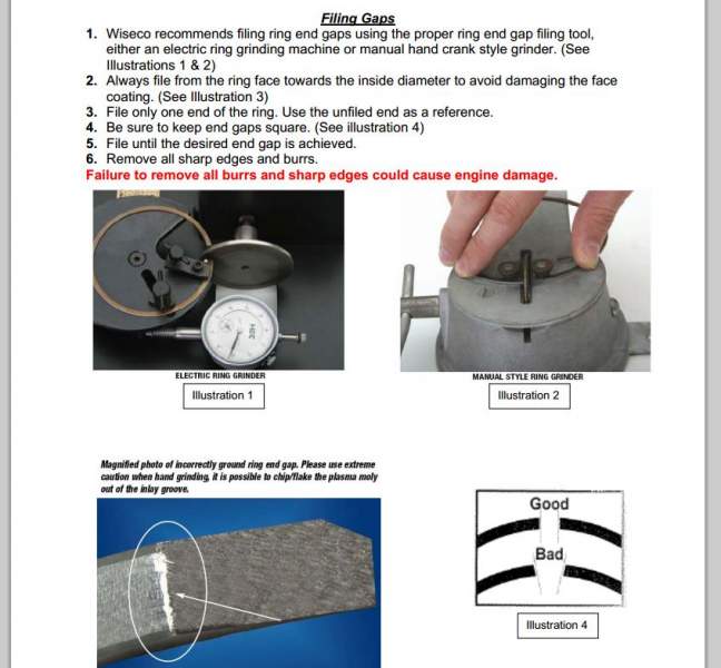

Gapping rings for wiseco pistons
image.jpgI have 87.5 mm wiseco pistons I just wànt to double check my calculations for ring gap
Wiseco spec for street moderate turbo/nitrous is as follows
Top ring calc 0.005
2nd ring calc 0.0055
Now take bore size x ring calc
For top ring bore is 87.5/25.4 to give fig in inches
So 3.44488x 0.005= 0.0172"
2nd ring
3.44488x0.0055=0.0189"
So top ring end gap 0.017
2nd ring gap 0.019
Does that seem right?
Checked the top ring with out any filing and it's 0.009" so I have to file 8 thou off to get 0.017"
Edited by hellraiser
Good little diamond file with the ring set in the vice between 2 pieces of thin wood is how i set my gaps Gary...dont need all the fancy gizmos iff you take your time. 4 thou either side is nothing.
image.jpg this is the first top ring I have tried. Needs 0.008" removing to get to the required 0.017" gap
[ATTACH=CONFIG]84244[/ATTACH] this is the first top ring I have tried. Needs 0.008" removing to get to the required 0.017" gap
