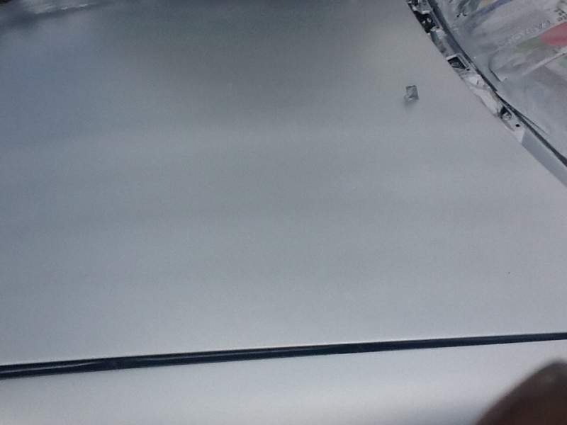

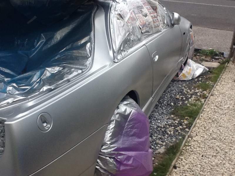

image.jpgWell started spraying think I'm going too run out of glitter silver Iv been on too the paint guys too see how fast thay can send me a extra 4lt just too be on the safe side

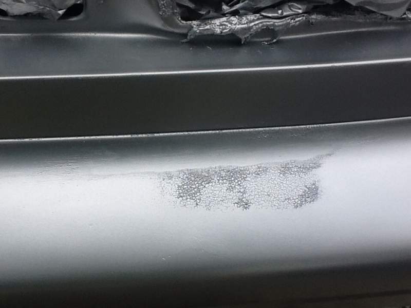

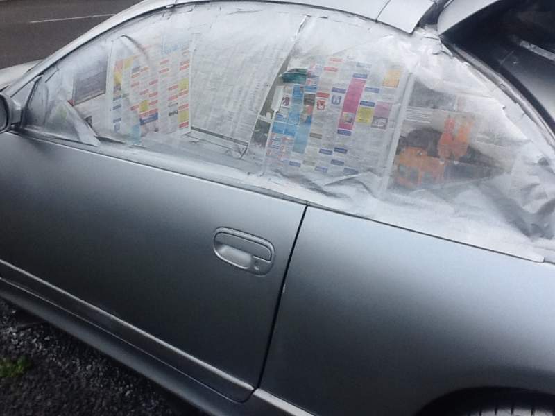

So far so good just got one problem on the back bumper started too blister so going too stop and let it dry until tomorow then sand it right back image.jpg
The base coat looks pretty good there Ted considering you are painting the bloody thing on your drive again :scared: haha. If I were you, I wouldn't apply the lacquer to the whole car at once if you have to do it outside. Mask off and do a section at a time and try to shield it from the elements and the insects that seem to be attracted to wet paint, and plenty of tacking before you spray.

I bet Denise is really happy that you have managed to change the colour of your driveway gravel from Buff to Metallic grey!:devil::ohmy:

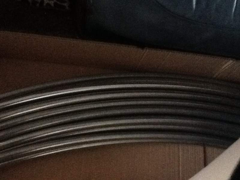

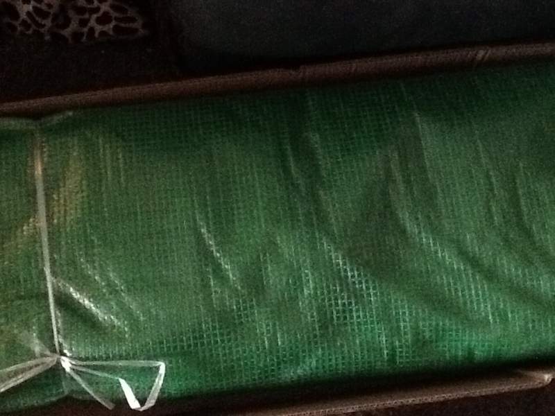

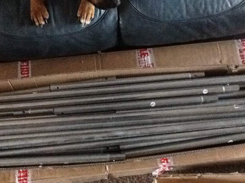

image.jpgWell the polly tunnel turned up sat its big so many tubes think it will take most of the day putting the thing together but once up I can start spraying in comfort and not panicking if it's going to rain

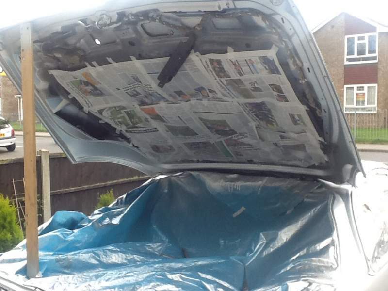

Had a right pants of a day redid the rockers hard pipes under engine cover in the glitter silver that was fine thought I redo the car in the silver just too refresh it as I'm waiting for the last of my parts and the engine hoist too turn up and fook me this happened not happy so had too order a isolator rerub down use the isolator leave for an hour or so then primer then re silver it then leave it alone image.jpg
Ah man! Sorry to hear this, don't let it get you down, I have to commend you for trying this yourself, I honestly wouldn't even attempt to do this, I figure I'll pay someone to do it and save myself a load of heart ache.
