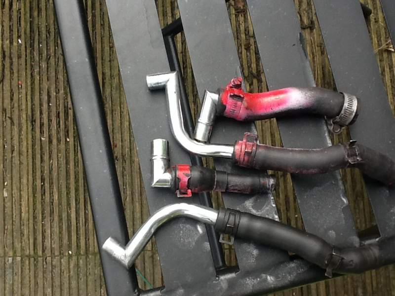

Well going to try stuff today polishing wise if it works great I'll put photos up if not oops I wont haha
Ok mate, don't keep us in suspense! What are you polishing out of interest, hope it's something from the ZED ;)

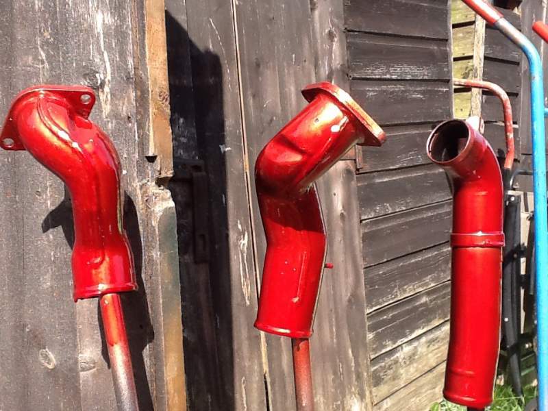

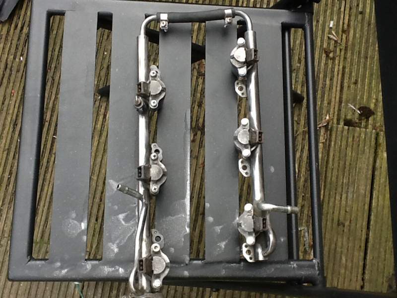

Looking good Ted, but may i make a suggestion.... I too polished my cam cover pipes as in pic above, but after a while they tarnish and oxodise and will look awful after a few months, i would paint them as im am going to with mine. They will not stay looking that good for very long lol, even if you try and keep polishing them.
I don't mind you makeing the suggestion bud I'll see if I can fined a good chrome paint to go on

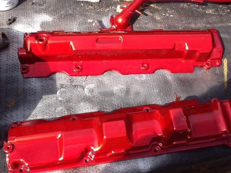

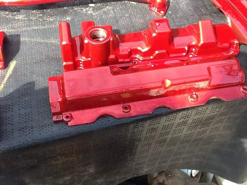

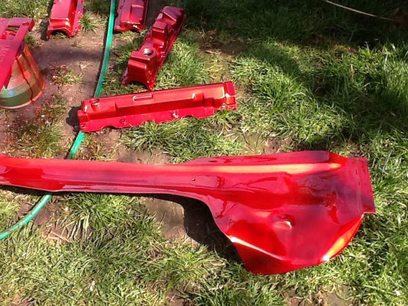

The candy red really seems to catch the sunlight Ted is it like that in real life or just how the photos are?

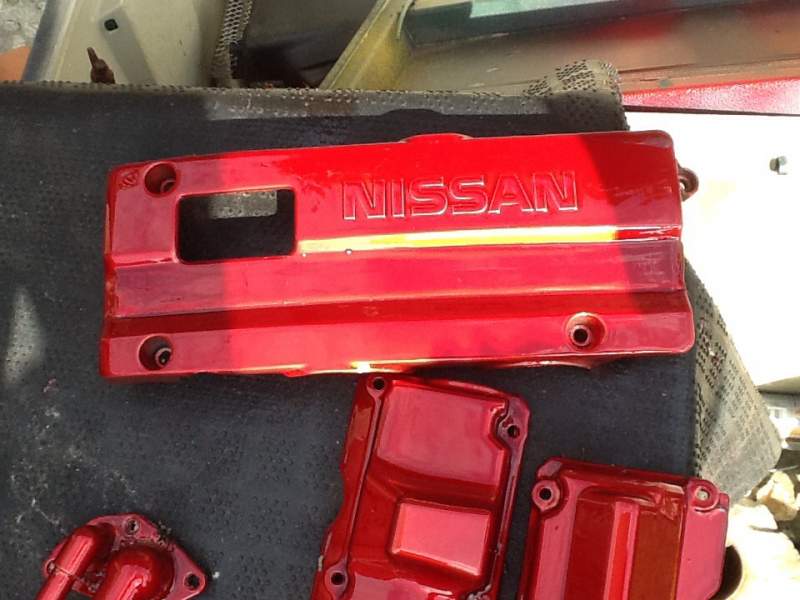

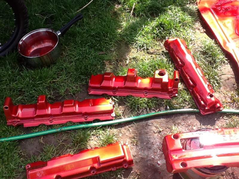

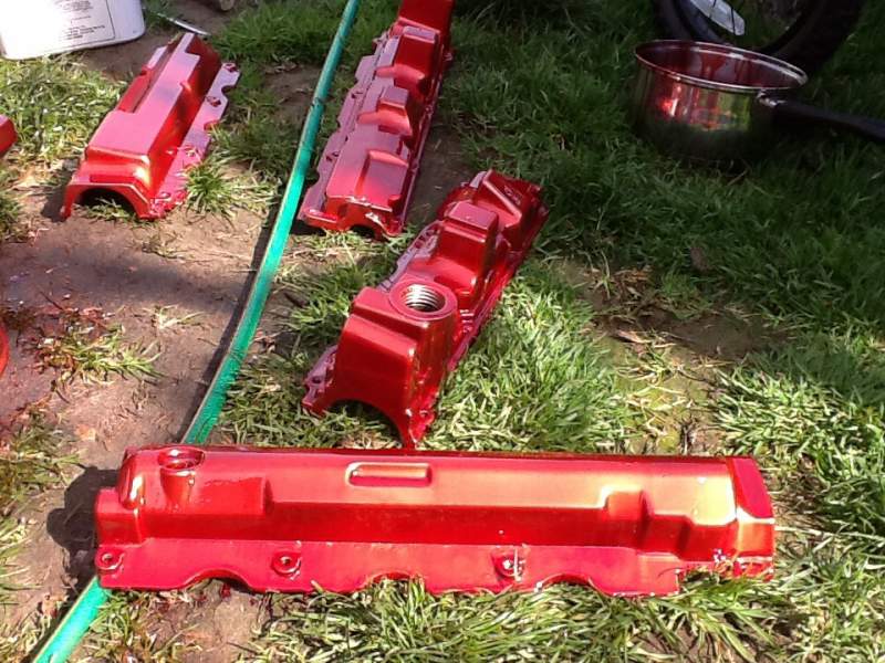

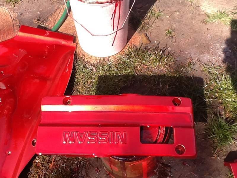

No mate that's how thay are even did the rockers again but in the candy some better photo baz image.jpg
You resprayed your grass too!
Haha yea and I got my ear bent for it, and using a saucepan thought it was a old one well it is now

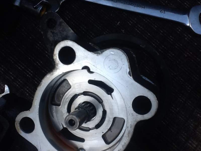

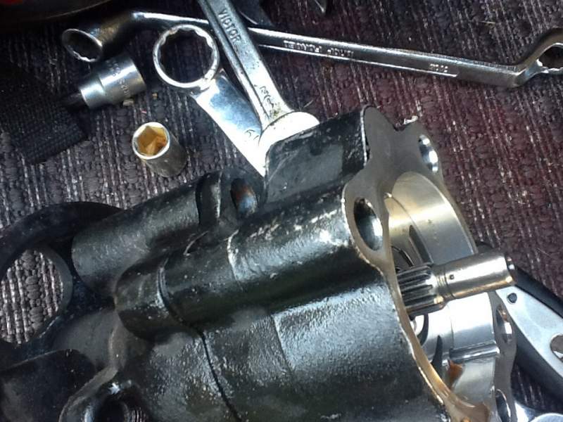

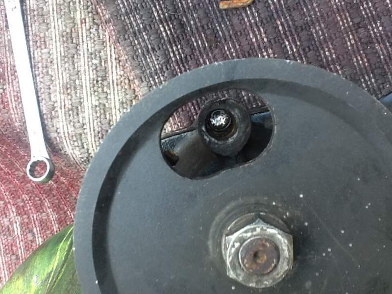

Right started putting the power stering pump on damaged bolt nice now the question is can I use my n/a power stering pump instead of a tt one image.jpg
If you have your hicas removed you can use the NA pump, you will also need to do something with the pulley or belt, cant remember which as the TT pump is slightly prouder/bigger.
Cheers bud bloody engine starting too bug me now
I have an NA PAS pot.....
Cheers si but I'm ok with the pot it's the pump that given me a headache

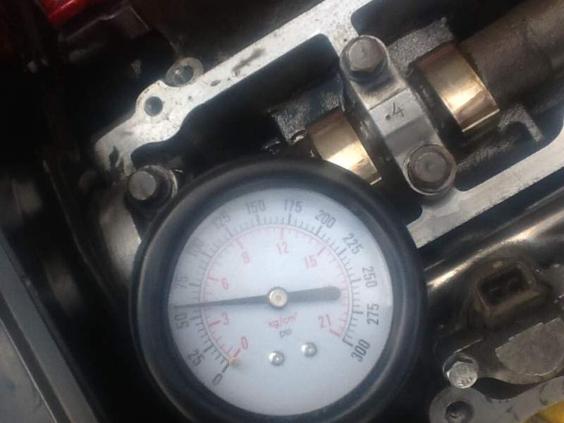

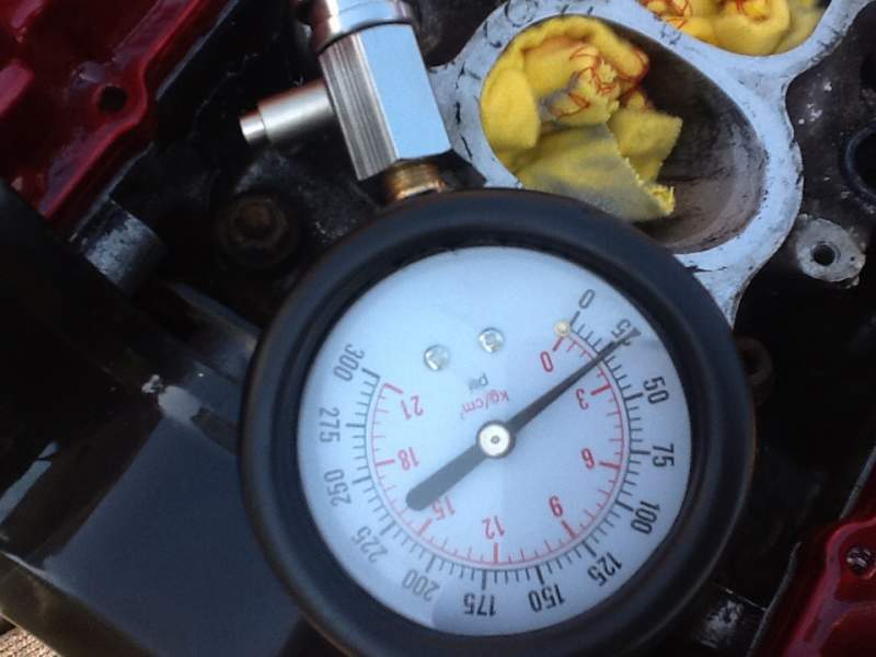

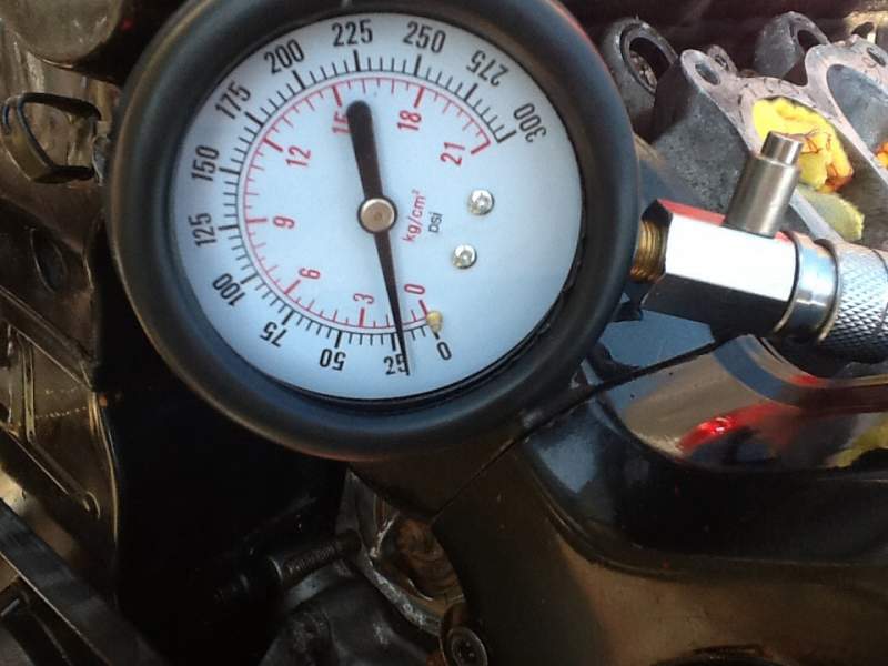

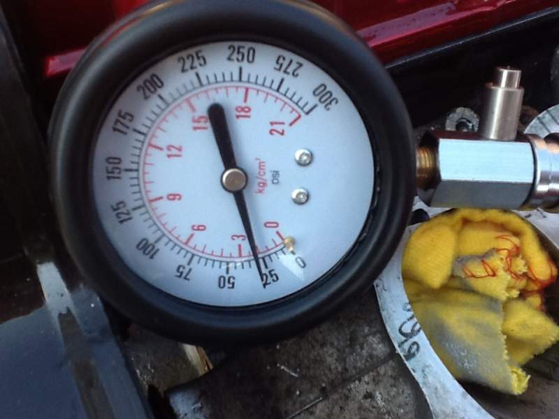

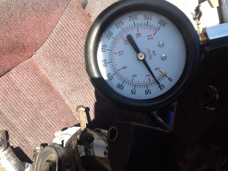

Right did the compression test 1=25. 3=25 5=25. 2=25. 4=30. But 6=0 but there compression there ?image.jpg now am I stuffed here and it was done by hand
Edited by ted
Best compression results I've ever seen.
A fresh TT should be around 180psi per cylinder I think
You can't do a proper compression test by hand.
Edited by Noz
Take out the fuel pump fuse, turn the engine over with wide open throttle for at least ten revolutions lol

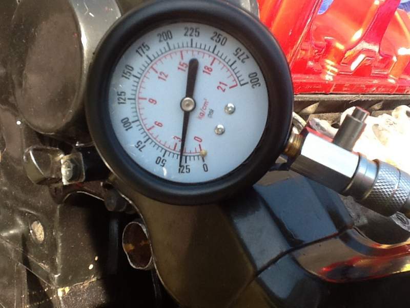

image.jpgWell put some oil down the spark plug now got compression back apart from no 6 but gone from 25-30 to 50 on the 1st turn of the ratchet
