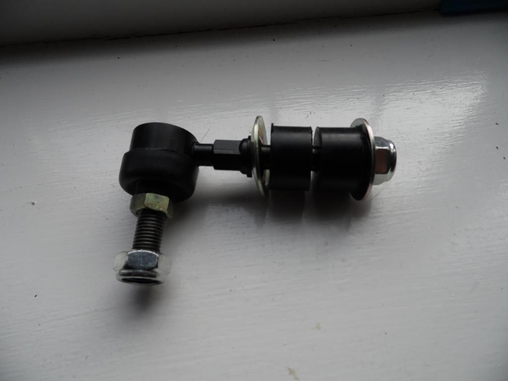

Okies, further to the above query, my new droplinks for the front have arrived today:
Are these going to be right ones to go along with a Whiteline front roll bar...? Cos there seems to be 2 different designs that I've found...!!
That looks more like a rear. The fronts are z shaped. If your whitelines are the same as my stillen ones you will need 4 Z shaped ones. Which is the same as a 200sx front.
Scratch that, that is a rear... The ARB doesn't change it. The front one is a z shape though. I used a 200sx front one at the rear as it was half the price and on the shelf.

It looks like they sent me a pair of Z31 ones, so they're going back and I've ordered a pair of proper Z32 ones instead!
What a nightmare.....
