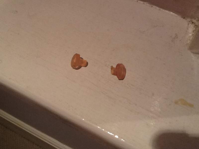

One month ago my brake lights stayed on & flattened battery!
A green rubber brake stopper ordered $3.25 postage $42.00! Sorted.
So I changed my Momo steering wheel for an original one, my cruise control did not work!
Another green stopper! There are two on the brake pedal & they disintegrate with age!
These fit the hole & with super glue to hold it in place! Hay Pressto!
Does exactly what the green stopper does!
& much cheaper! :dance:
