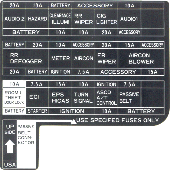

hi all , ive looked on teh fuse box and the fuse lid in the cabin footwell, and i cant find which fuse is for the overhead reading lights and clock as both had gone off....any ideas ?? or has anyone changed theirs recently and knows which fuse it is ?
cheers people
Steve
Bottom left of the drivers fuse board.
10 amp fuse.
Number 15 if you were counting left to right from the top.
