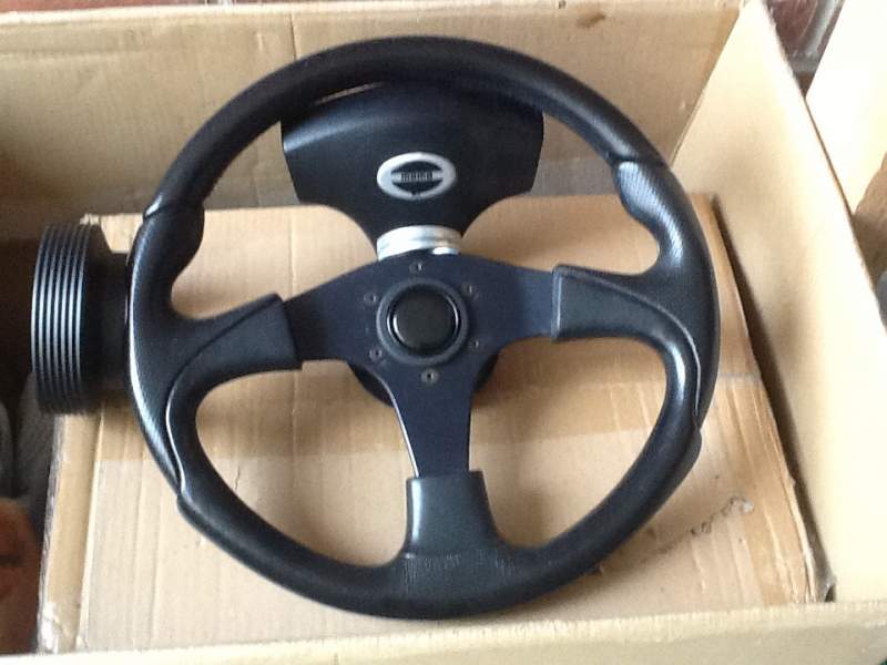

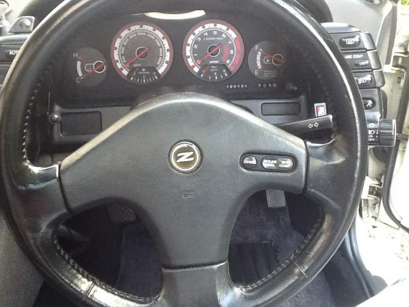

There is only one electric connector to connect on the wheel!
So if that is the case where do I look now :)?

Well it's a TT jap import 91!
It has the pod wiring.
I have check it at 50 60 & 70 mph
Will check relay & used to footwell pedals as I had to change the green stopper for the brake lights staying on!
Ah, whoops, didn't spot that in your pic. :blushing:
