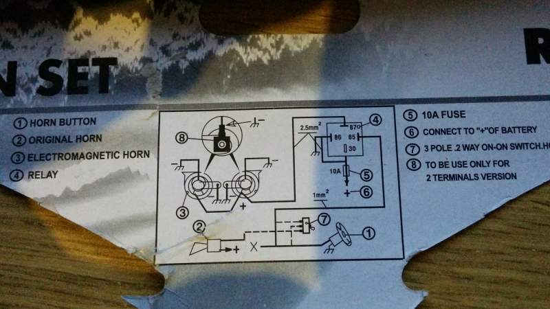

Need to get my horn fixed before I put my front bumper back on, I have ditched the stock horns years ago and bought some more. I can't get them to work, fuse OK, Relay OK and continuity to the horn wires OK.
A couple of pics underneath to see what I've got, I have tried both spades on the horns and the earths have been done correctly, any ideas?

All sorted now, one of the pins was an earth not just the bracket. Only used one horn, its sufficient :)
