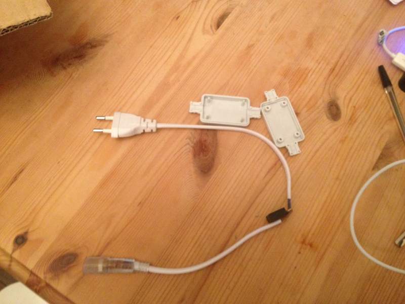

1) A euro 2 pin plug with no fuse....... Okay you can use an adapter!

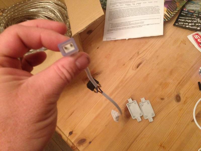

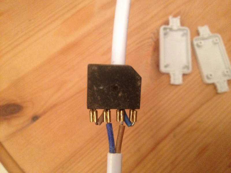

2) A diode rectifier in a plastic box in the middle of the live wire....... The box fell off when picked up exposing all the live mains wiring...... Absolutely lethal....
3) The connection to the LED strip is 2 metal pins pushed into the rubber sleeve.... These fall out of the sleeving exposing 2 sharp pins that if plugged in would be UNFUSED and LIVE........

The only thing attached is the bridge rectifier they used...http://uk.farnell.com/multicomp/kbl405g/bridge-rectifier-4a-600v/dp/1621729
The strip has 2 lengths of wire carrying the 240v embedded in it either side of the LED strip, the resistors they used are on the strip.....
So the wire running the full length of this is at 240v DC with no fuse..... so should it get cut or damaged it would expose this..........
