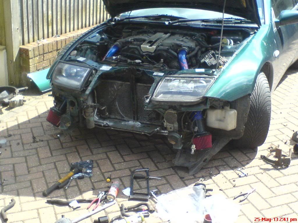

is there any dirgrams or drawings of a short ram daul split intake system about? or is it the case of just finding means to make your intercooler (fmic) pipework shorter and the air intake as close to the tubs as poss. or have i got it wrong. thanks
It's nothing to do with intercooler pipework. Filters sit where the standard sidemounts reside.
It's on an na in the picture but it's the same setup I used on a tt with an fmic but I can't find any pics of the tt.
under the head lights is a nice little hole which you can feed a pipe through and connected up to the intake pipe of the turbo, I used 90 Deg pipe with about 4" of striate, fitted in real nice. The hardest part was taking the head light out :)

I don't know of any Zeds other than Jaffa's and mine that run custom intercooler pipework. As it stands, I don't have any compressor inlet piping, just some mesh.

not even a filter, mind you if you put there itll propley melt. you not to bothered about getting any crap in there noel?
