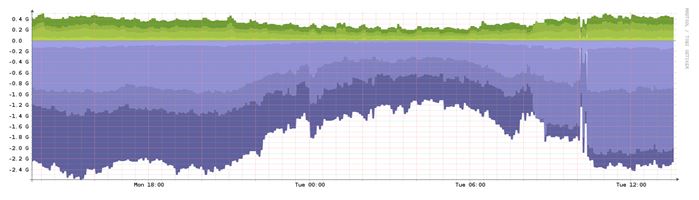

Below is the graph of one of our many connections to the public internet to demonstrate. You will see a small drop in traffic whilst the issue was occurring and 2 additional ‘blips’ which are due to the router reloads (more details below) but otherwise traffic levels were only slightly affected. The arc you see is unrelated and is part of our daily traffic flow, which naturally drops overnight.

Due to human factors it took us approximately half an hour to find the cause of the issue. At that point we applied a fix on the only router we believed was affected. This took effect after a reboot (which caused approximately 60 seconds of packet loss as indicated on the graph) and the majority of people who could not access our network were then able to. However some users were still reporting problems so we continued to investigate. We believed the issue may lie elsewhere as customers were also reporting issues reaching websites such as eBay and Skype but, despite the lack of any log entries to indicate, it turns out another of our Cisco routers had also hit its routing limit. The same configuration change was applied to that router and, at that point, the remaining people still having problems accessing their site were now able to again.
