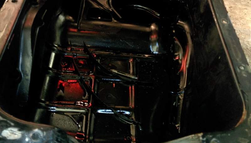

Got the dipstick out but the scale has pulled off and is in sump.trying to hoover it out at the moment turbo return n sump plug with absolutely no luck as expected. I think the best way would be to cut a plate out of sump and reweld a section back in. Don't think I'll be going down that road though. May have to do what you suggested Andy but as a last resort cheers.
Also thinking of leaving in...........would be easiest :oops:
Did this very thing myself years ago and the ONLY way is to drop the sump, the part that has come off will be trapped until the sump is removed cutting a section out will not help you due to the baffles.

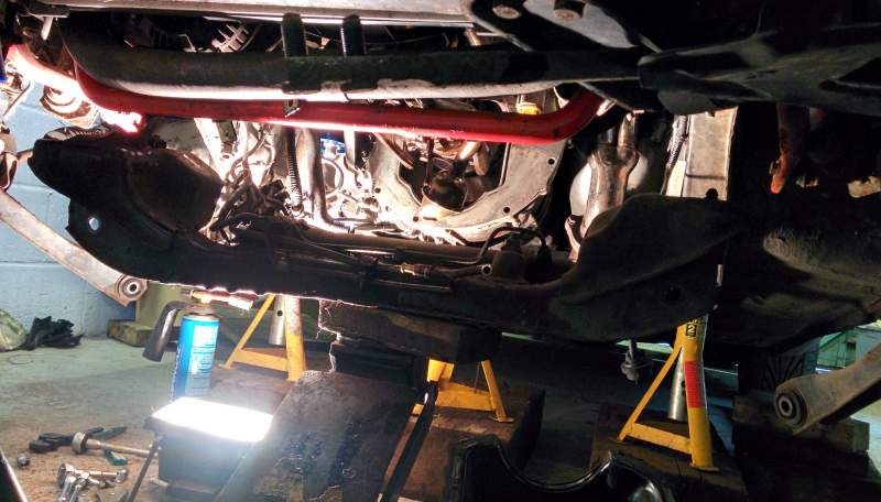

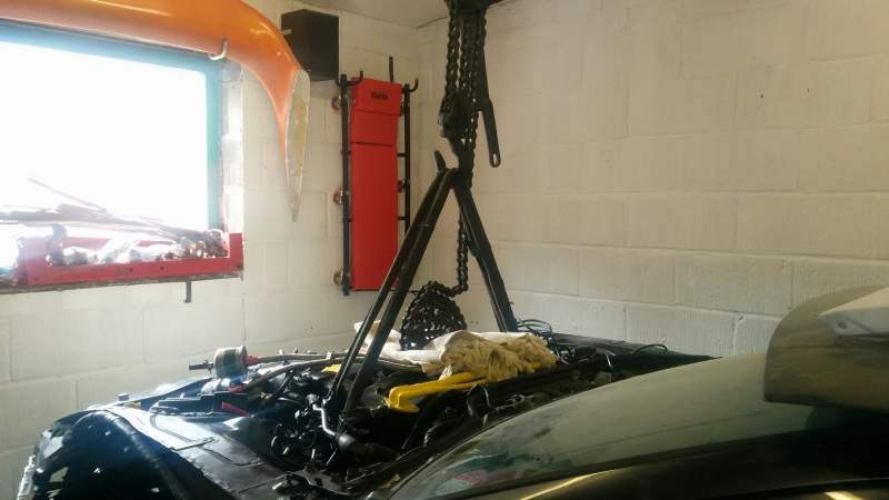

Got the sump off with the sub frame on got about 12-15mm clearance , still getting nowhere going to have to borrow some engine lifters for the sides of the plenum to go with sub frame removal like Andy's suggested, not happy but gotta get on with it, I've put some fresh petrol in today and bought the antifreeze so still going at it.
Well got it out yesterday afternoon and nearly managed to get it all back together again last night, wanted to do some final checks this morning before I jacked it down again.
This was actually a fairly easy and pleasant job, but one I wouldn't like to attempt on a driveway. On TT net the fella had a two poster ramp, a proper engine support (the type that goes on your wings) and a transmission jack, he was well kitted out. I have an good garage space and some good equipment and at first I was a bit unsure. If your going to attempt to do this be careful!
