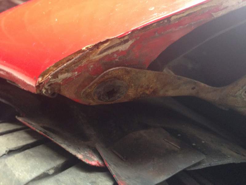

Need some advice please this corner nearest front wheel, how does the bumper attach to it?
It was so long go I can't work it out, does that bracket come out and the bumper go in between the wing and bumper?

I think the bracket needs to be behind what you are showing and a fixing screw goes in the center of the black fixing to hold the wing on, hope you get what I mean.
Ok thanks, anyone care to confirm this before I get busy, lol
Should the black screw grommet be in the wing?
That way the screw attaching the bumper to the wing passes through the hole in the support bracket.
