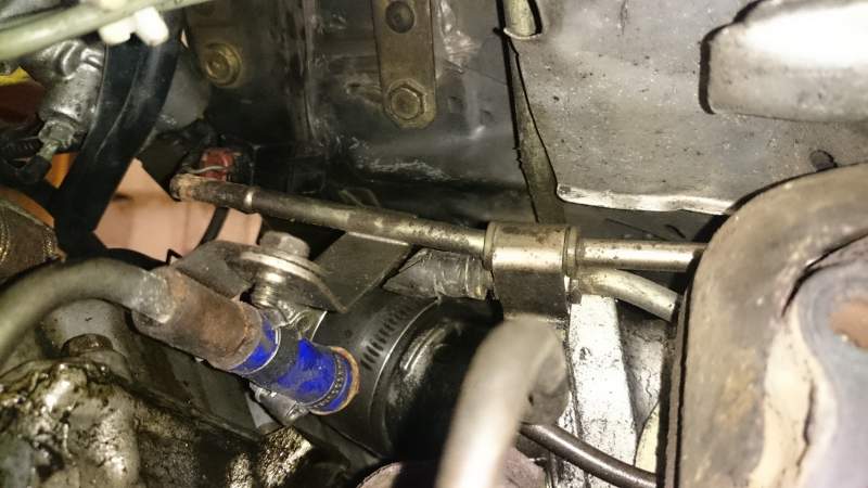

finally finished the decat install and in process i found this
[ATTACH=CONFIG]81332[/ATTACH]
the blue pipe is capped and above it is a metal pipe which has nothing on it and in between the two a black pipe which has been cut. anyone know anything about them or what delete they are associated with?
thanks
thanks
someone had deleted the water supply to your turbo or turbos ... Prob due to a water bypass or making the turbo change easier
in my opinion the water supply to the turbos should be connected .. just helps with heat and longevity of them ..
but others will say its ok to what i know there are no reports of failing turbos due to this delete but could of been done alot neater thats for sure
