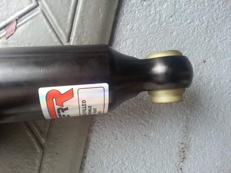

I've forgotten which way round the coilovers should face on the front.
Does the longer end of the bush face the leg or the nut facing towards the front of the car?
The coilover looks really close the the suspension leg if the longer end faces the nut but want to make sure.
Thanks Dan
Edited by GIBSTER-TT
Surely the sticker will be facing out Dan?
I fitted them with the longer part facing the arm to give more room. The sticker faces in.
