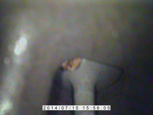

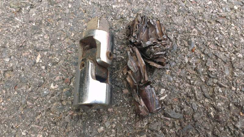

CAT material in the head
Debris removed

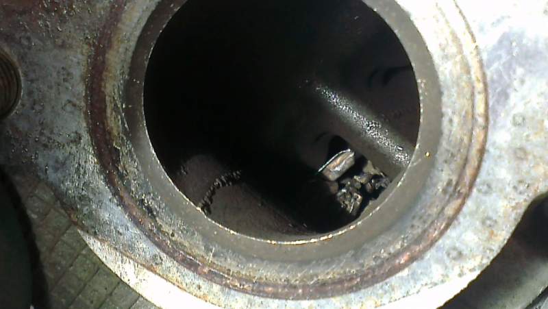

Debris in exhaust manifold

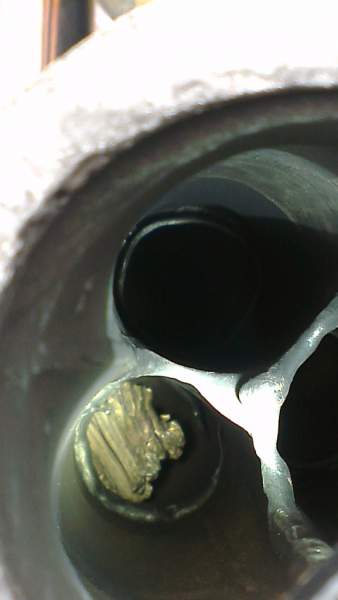

Poor probe photo, but Debris cvan be seen at the back of the exhaust valve
