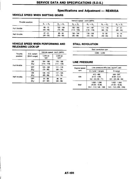

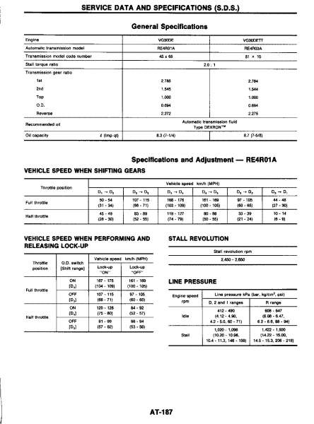

Cheers guys.
yeah, already got the TPS checked with a guide Jeff from Zedworld sent me. Set it to 0.46 as recommended (was at 1 when we first put the multi meter on). This doesn't seem to have made any difference at all.
Ted, can't seem to read those docs, or the ones you PM'd me. they are too pixelated.
Peter
yeah, just got the link and had a quick look. I'm not at all mechanically minded so most of that looks like swahili to me. think i get the general gist though.
