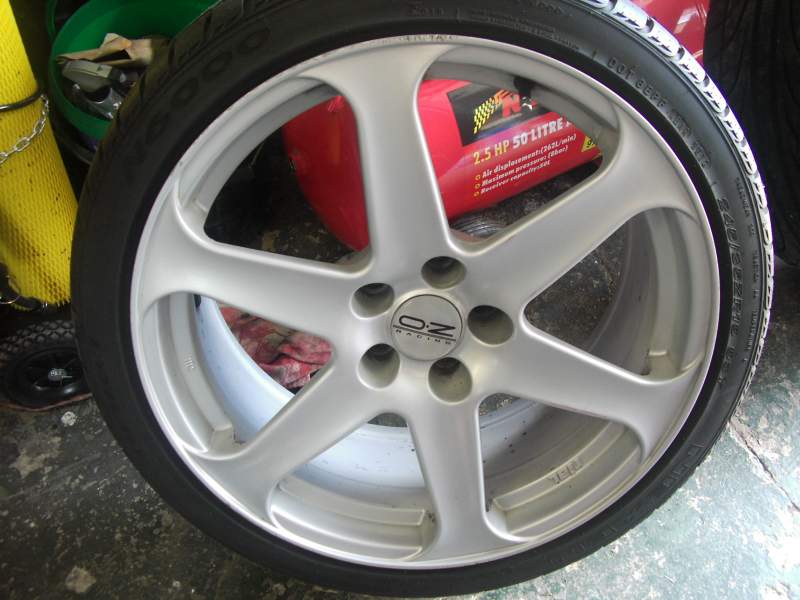

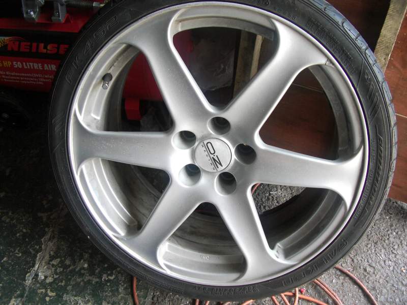

Dropped the price on these.
19" Rial wheels with tyres,
Front and rear 8.5 ET30 fit to a zx without arch rolling,
Front tyres Nexen N6000 ZR 234/35/19 loads of tread left
Rear tyres Falken 452 ZR 265/30/19 about 3mm tread until wear bar
and showing some signs of light cracking.

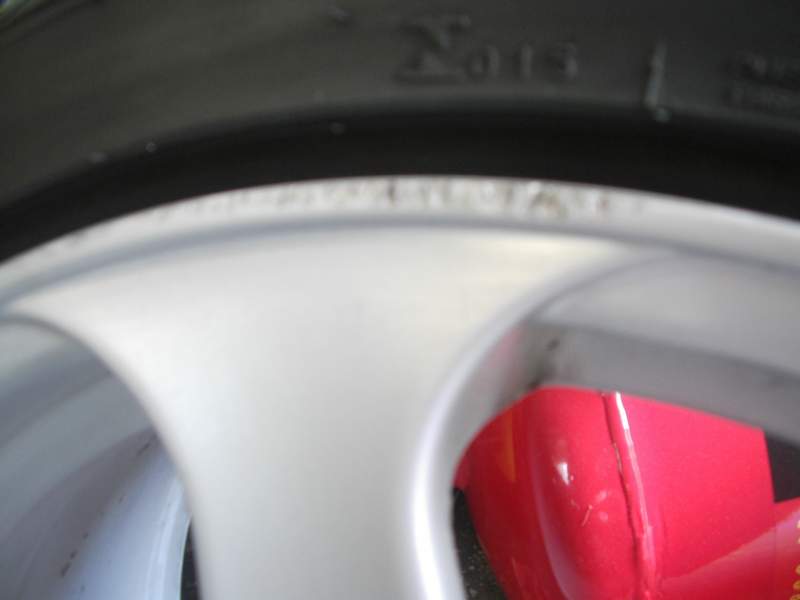

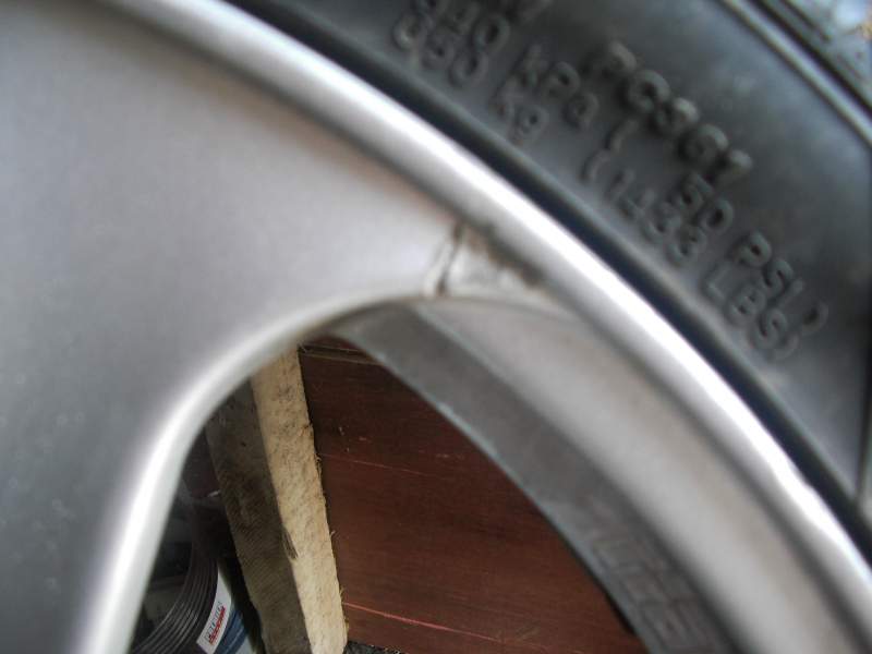

Some curbing (see photo's) someone handy at diy could easily sort this out.
Two sets of center caps OZ and Rial
I have no wheel nuts for these wheels
Viewing is recommended
Price £600 pickup in person is preferred
I will have to post picture over a couple of threads
Edited by 300_zedx
Price reduced
