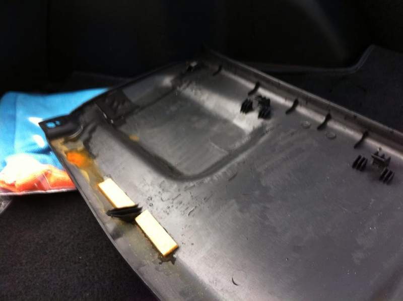

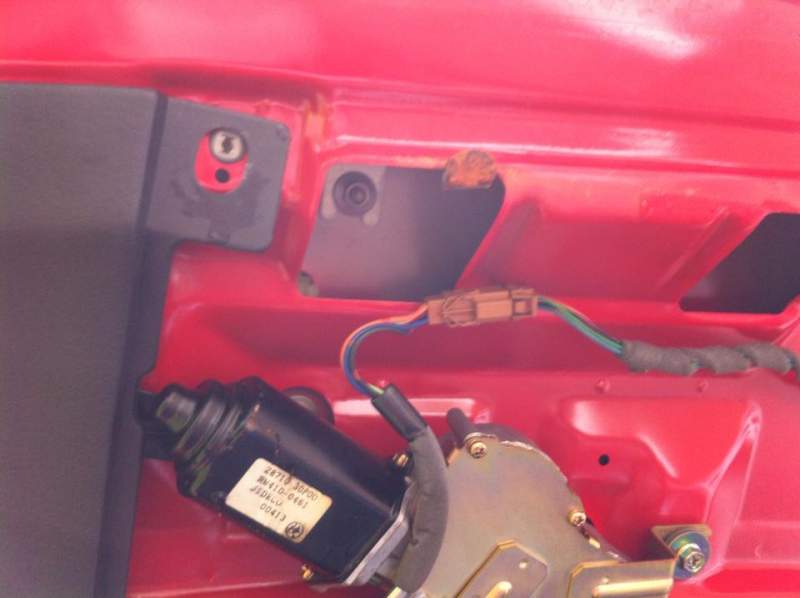

Just noticed a very similar leak on mine today, minor one. I don't think it's coming from the spoiler but the wiper is a possibility. Which spoiler do you have?
Rust spot for reference:
I've yet to have a thorough look but I don't think there's any signs elsewhere.
