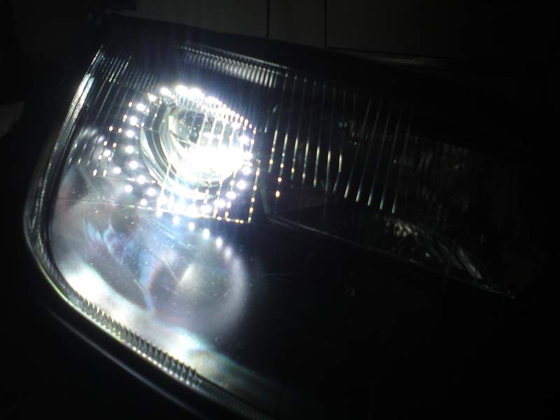

It involves putting a smd halo ring around the projector housing, doesn't really show up on a pic but in real life the lights emitted are all individual.

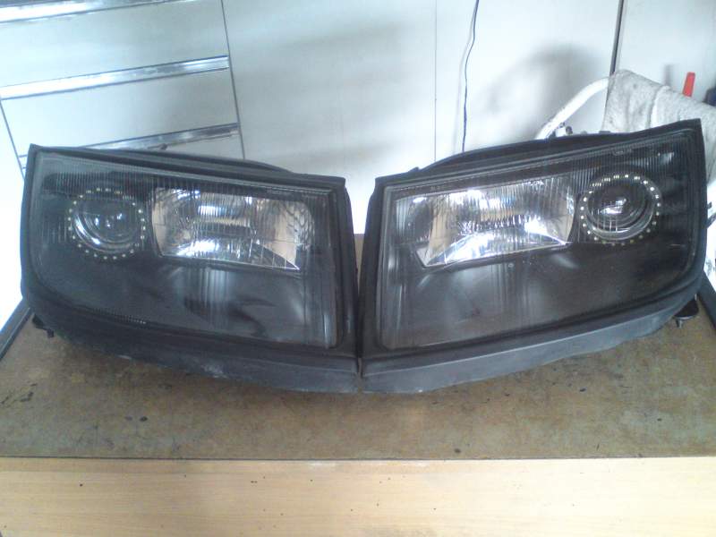

I completely re furbish and clean, I have sprayed black the insert as per customer request, the top and bottom rubber brackets have been rubbed back and black sprayed also, the bottom one is not visible but the top one is, so it's important this one especially is perfect. All the adjusters are now working and well greased for what is hoped longevity, 4 silica gel sachets are inside each unit to absorb any moisture.
This is a pic of course when not on. I have fit some blue tipped H1 bulbs in the main beam for free, when daylight hits these they give off a subtle blue look.

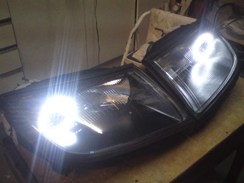

It takes me several days to do this work, leaving things to dry or go off overnight. This next pic is showing the halo and the hid light on, the halo smd is still visible even with the dipped beam hid on. The hid kit I have fit is H3, 55w and the colour is 5000k.

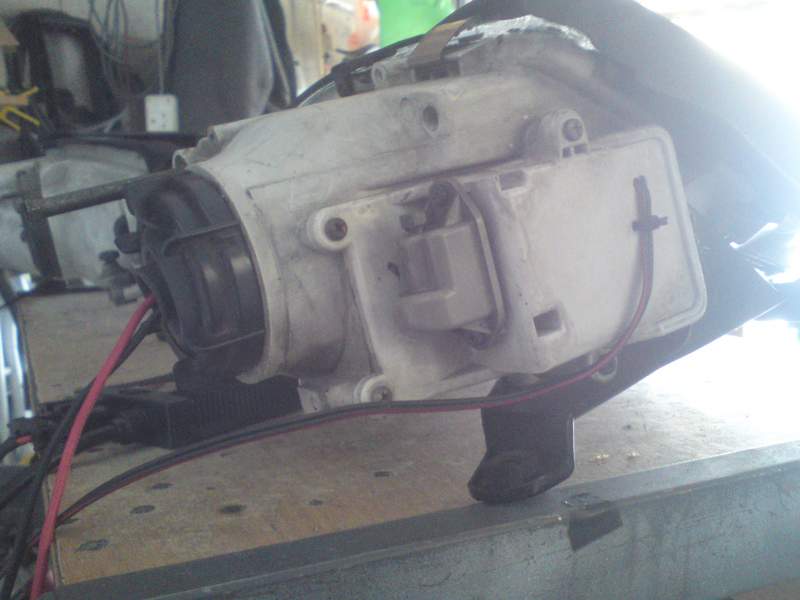

This final pic shows the exit point of the two wires that run the halo, these just need connecting to the side light circuit, the hid ballast is visible also in this pic.
