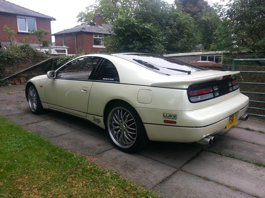

I have a set on my Uk TT and look ok, i will be changing them when ive done some work on her

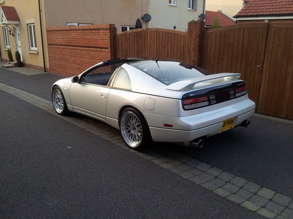

Jdm cars have the same width front and rear, only the uk spec cars were staggered i beleive, my jdm alloys are the same all round. I currently run team dynamic mania 19" wheels 8.5 all round with no issues.
