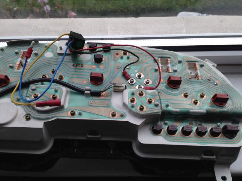

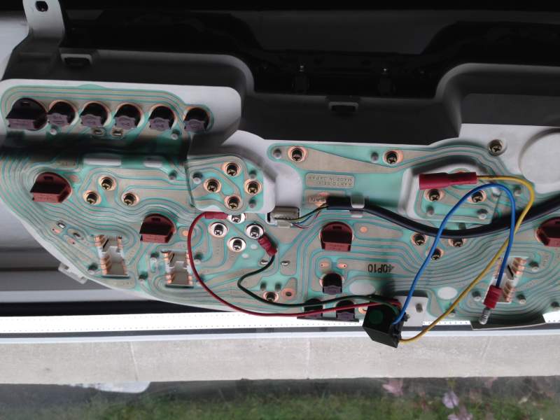

I have recently purchased a speedo converter to mph from sva car parts who i have delt with on 2 other occasions for jap hondas so i know they work well however when fitting this one its designed to fit inline on the loom before the plug to the speedo and their instructions on this arnt very good so being the fearless car enthusiast and the fact ive done it before took the plunge to try and unscramble thier instructions along with good old common sense and a multimeter fitted it all up then did the long job of putting it all tidy and putting it all back together job done ...... Or so i thought .. While taking it out last night to take the rust off the discs ;) the speedo bounced a few times then sat static on the bottom of the clock or 0mph to be precise can anyone tell me which colours/wires i should have spliced into as in assuming its an earth issue not a signal pickup issue as a similar problem occured with my prelude bb4 . Pictures or a nice diagram would be a blessing if possible also to check 100% the plug look i should be using for earth live and signal feeds . Cheers guys in sure ill owe a few people a few beers but i don't care if it works :)

Cheers guys although my signal wires on my converter are yellow and grey not orange and green so not sure which way round they are ment to go on the speedo anyone know the answer please ??

Really not sure if this helps you. My car is a series 1, currently swapping mine out for a UK spec clock set :biggrin:
I thought a member on here had 2 UK clocks for sale at £40 each, would recommend doing this for accurate power steering and rear steering control, but otherwise here's a pic...
That's ok thanks for all the help guys ive sorted it even glue gun glued it all in place save it moving yay working speedo in mph and is accurate as my gps well give or take thanks again guys :)
