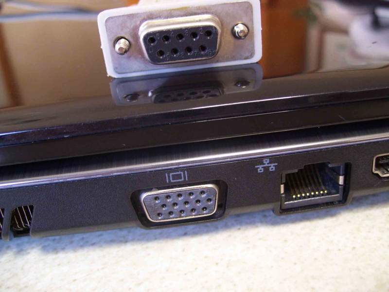

In brief, I have a Dell laptop with a 15 pin female serial connection socket.
My Data Scan cable has a 9 pin female serial connection socket.
My question is, how do I adapt the two without affecting the software function?
Can I use an adaptor of some sort?
If possible, I would prefer to remove the existing 9 pin female socket from the cable and re wire it to a 15 pin male connector.
Is this possible? If so, would anyone know the correct pin wiring please?

what co;our is your 15 laptop connector blue or black
Blue is normally VGA
Is there a symbol on PC case next to port?

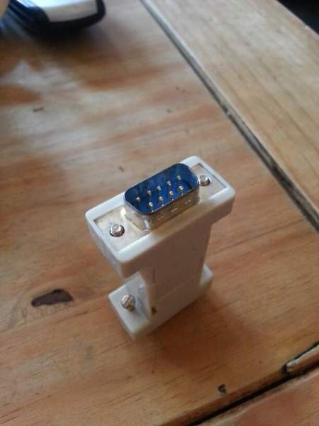

Ive got this. Any good? It's the same both ends male. uploadfromtaptalk1399203250786.jpg
Sent from my GT-I9300 using Tapatalk
hiya did you get the adaptor mate ?
I did mate! Thank you so much.
I have since realised that I need a 9 pin to 15 Doh.
