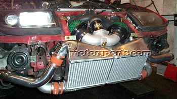

Hi, looked under the front panel and saw the air filter, not ever having a std one, is this one std or aftermarket

That particular design is normally part of HKS's front mount kit:
There are a lot of copies about for the filters and the ICs. If you plan on keeping the filters then
make sure you follow the replacement regime. The filters are the dry type (don't oil). HKS state
replace every 6 months or 6K miles. I do mine every 12 months as I do less that 3k per year.
