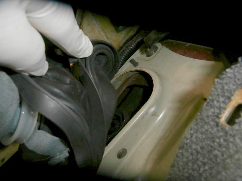

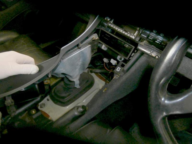

For anyone with manual gearbox noise in second and forth gear but quiet in other gears the most likely problem is just road and normal transmission noise getting into the cab area due to the lower and upper rubber gaiters coming adrift simply accessing these and ensuring they are correctly fitted will stop the noise.

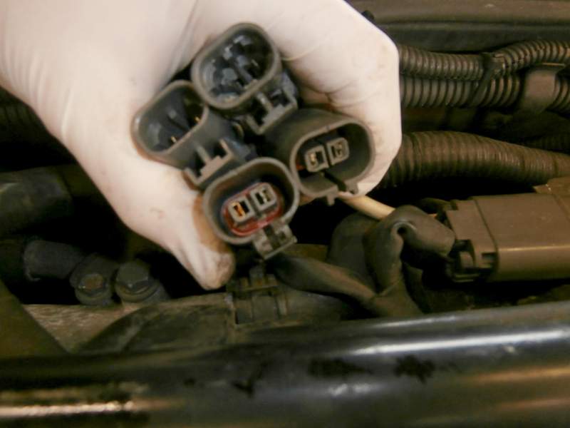

Electrical connections on the engine can be trouble some but a common mix up can occur where the det sensor connector and the nearside vvt connector get mixed as oddly Nissan made them interchangeable and located next to each other. The result of the sensors been mixed is safety boost ( lower power ) and one side of the engine been unbalanced as the vvt is not working, check the two connectors and follow through the cable colours to be certain.
