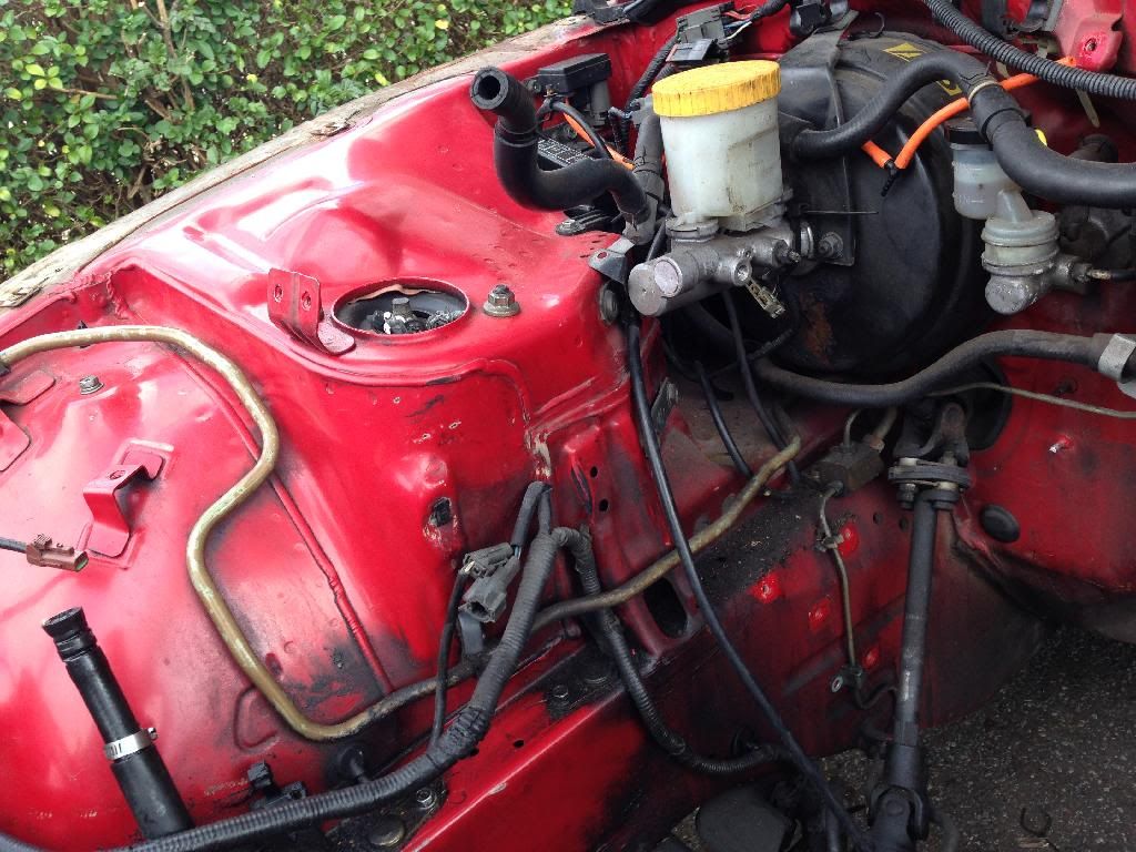

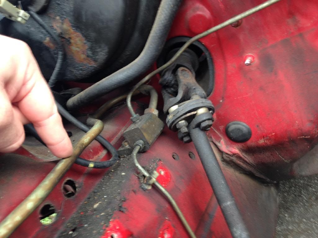

What's this pipe for? It runs to the block then goes off to the clutch cylinder
Is it needed? I plan to run a single pipe down to the clutch cylinder and do away with this bit of the pipe
As above its the remote clutch bleed nipple and pipe, most do away with the long run of pipe in favor of a braided hose direct to the slave from the master cylinder.
Yeah just sack it off... Bit more weight gone from the car lol
