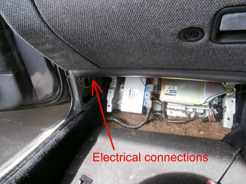

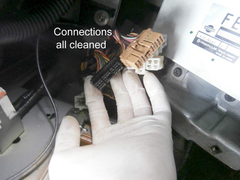

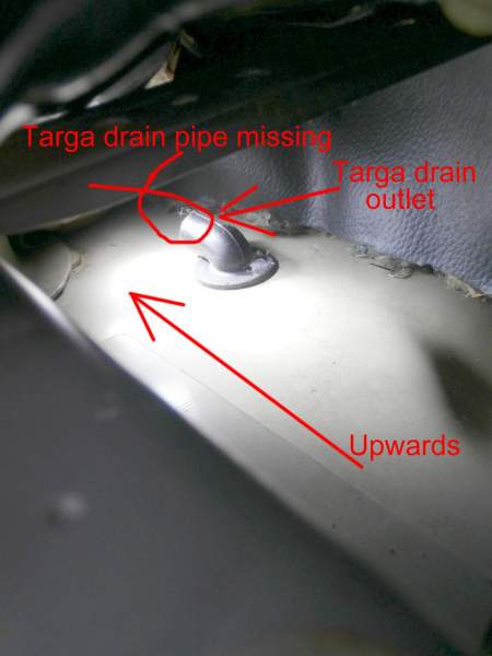

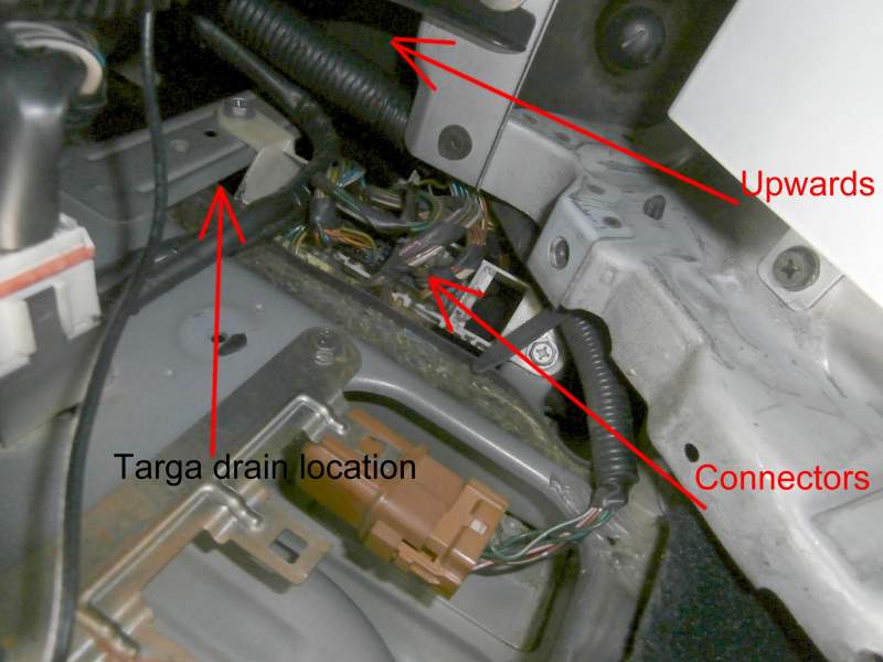

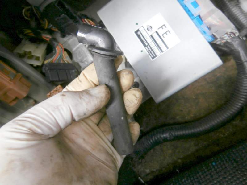

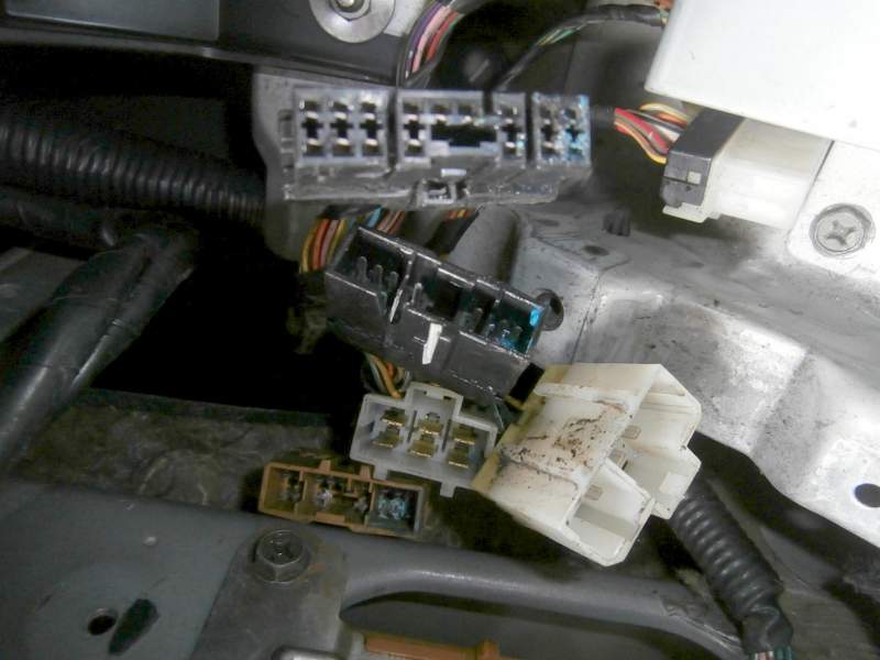

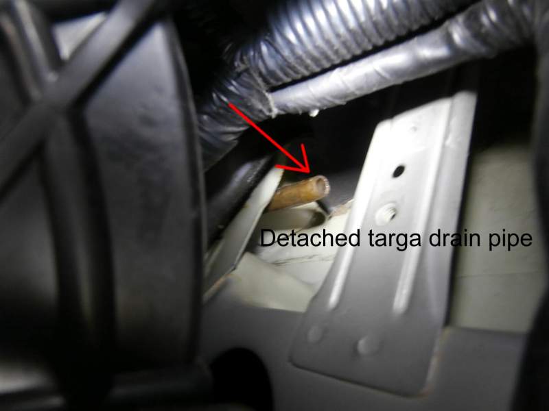

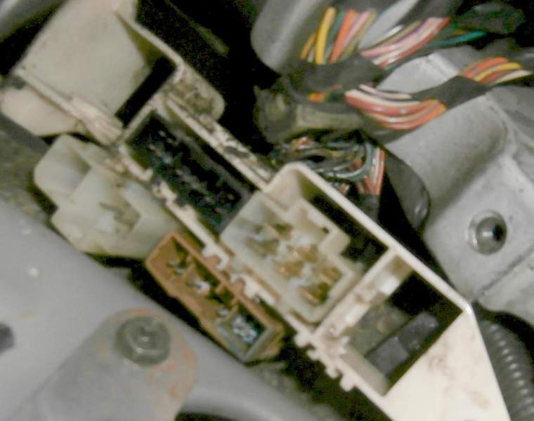

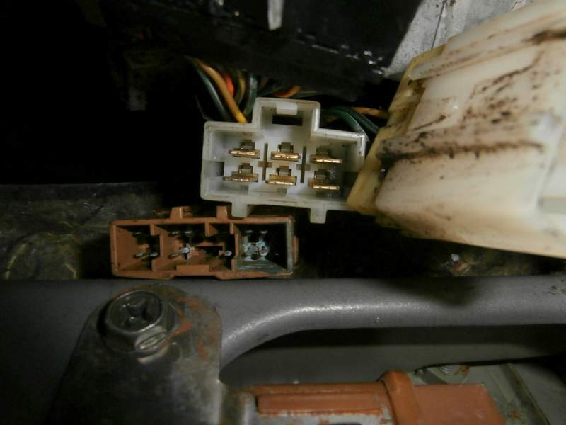

So passenger side, very quickly found the targa drain was detached and had been allowing rainwater to flow all over the main connector blocks in that area, pulling the connectors apart revealed green and corroded pins.
A very difficult area to work in and a sore neck is guaranteed the next day!! after cleaning the pins with WD40 and the air line blower I sorted the drain pipe so the same issue will not occur and a test showed we now had a good tps reading and a smooth auto box once more.

Just sorting out this issue today - passenger side. I can't reach the targa drain outlet from underneath (the bit in Jeff's picture). I guess I need to start removing things? Anyone got any tips on access, or pointers to other posts?
Thanks
David
Try and get someone who is flexible and has small hands, real pig I dumped the black piece and used hose pipe fitted exactly. I will eventually replace it. Lol
