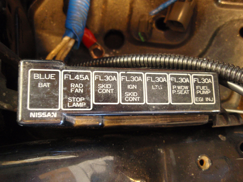

Hi guys got a problem with my front seat used to work but suddenly stopped. Took seat out and checked wiring seems ok and there's voltage to the main wire and switches when plugged in. Motors you think? Or is there a fuse somewhere?

Do you mean that you couldn't locate the fuse location or the fuse itself was missing?

Hi andy couldn't find a fuse anywhere

Have you found the fusible link holder (the black oblong box in the picture above)? It is located
just behind the drivers side suspension tower. The fuse is marked "P.WDW P.SEAT" (2nd in from
the right). Pull the cover up and off to see the fuse itself.
Ok andrew ill have a look tomorrow thank you for your input.

Hi Andrew ive checked the fuse and its fine I guess im looking at a motor issue then? But looking at the seat underneath seems there's a couple of motors wondering why they have both gone, seems odd
