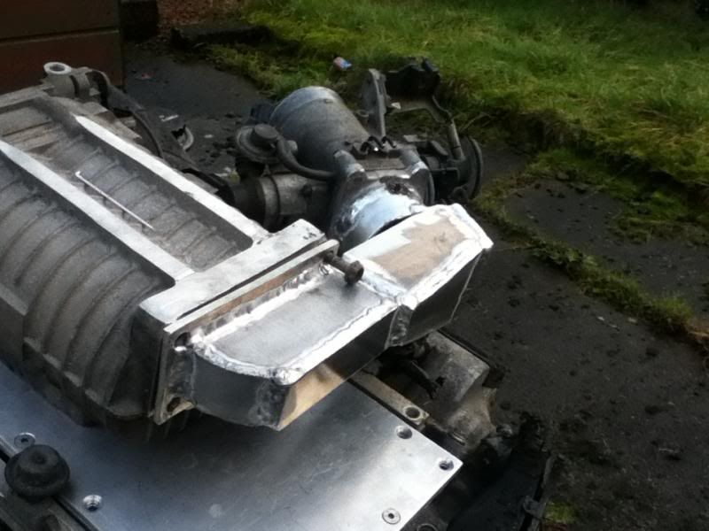

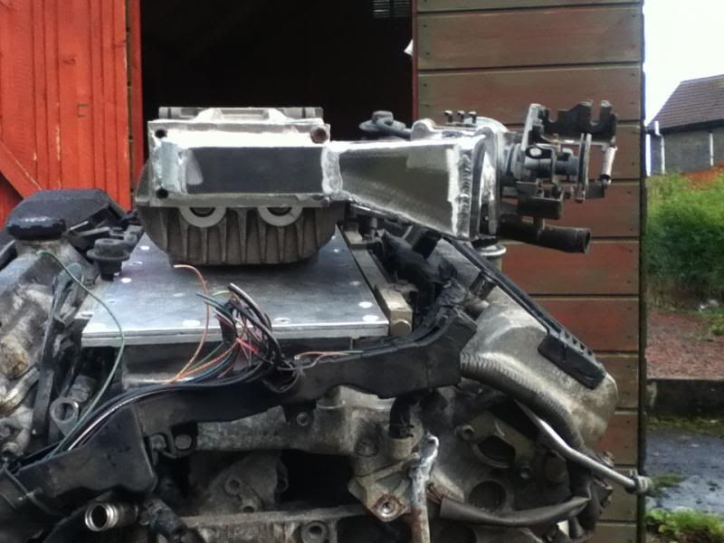

I made this as I think the 1uzfe needs a power boost and all the kits for sale cost 3k+
This is just a rough draft to get everything positioned, the next one will be 10mm lower ( currently 34mm taller than a standard plenum) and required less welding and the parts will be cut from entire sections rather than pieced together with bits I had sitting :)

I have also got a second idler pulley added for more belt wrap.
I have done the calculations and it should push between 7-10psi (I worked it out at 10 psi with that size pulley but so many factors can affect it) which should give 380-430 bhp with a proper map.
