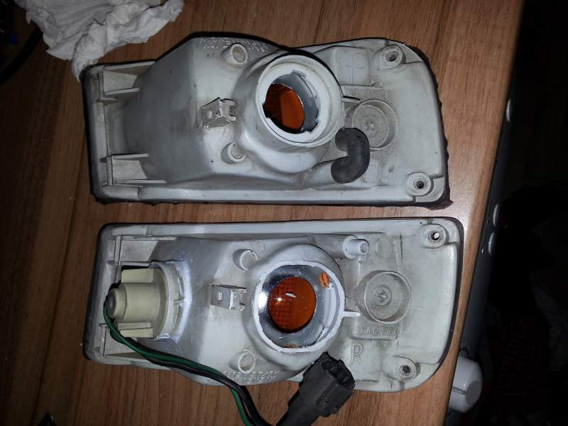

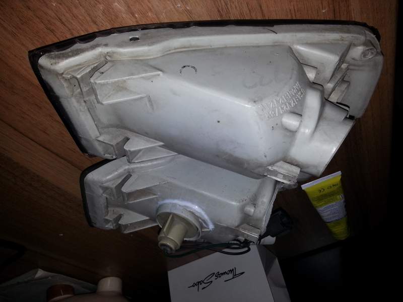

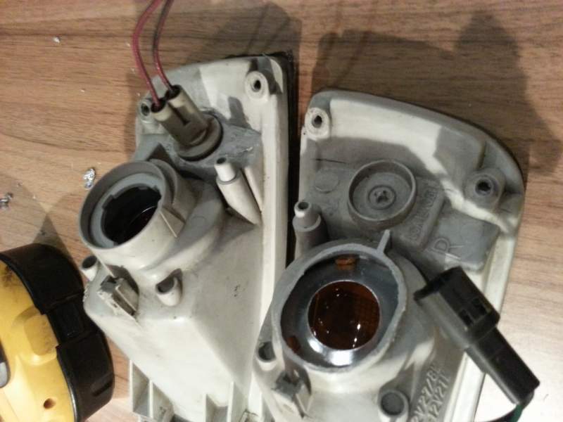

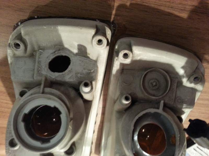

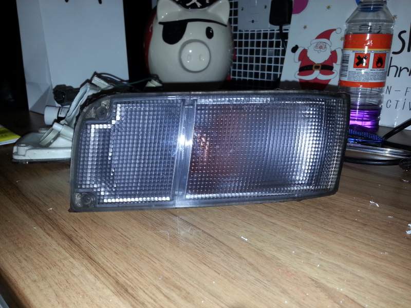

Ok so I've been busy since deciding to have a go myself.
The way the standard indecator bulb sat on the fitting stopped me from fitting the light in the bumper as it hit my air filter after installing the z1 doolz kit. So ive relocated the hold to the other side. I will us l.e.d amber bulbs.

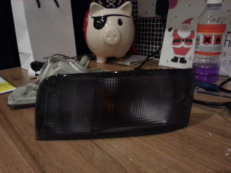

Ive also had a quick go at tinting the lense that turned out well with some film.
Results so far....
Nice work mate :thumbup1: I take it you've blanked off the old holes and sealed them up against moisture ingress?
Thanks bud. I will do once the no nails has dried. I will be fitting the side lights next
I did a similar thing with my UK spec. I didn't like the front sidelights being like tango'd foglights. So I dremelled the side light blanks and relocated the indicator part of the loom to them. I then replaced the UK front lights with JDM fogs and put a 6000K LED sidelight in them. Makes a huge difference.
Thats a great idea. Do you have any pics?
