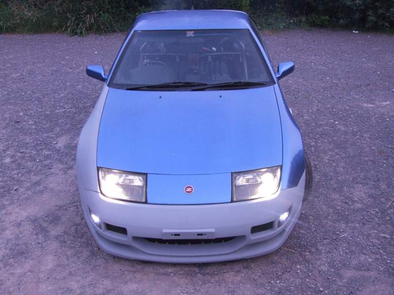

These are my dipped beams with 6000k, which I am very happy with how white they are. Anything from 4000k - 6000k would be ideal.
