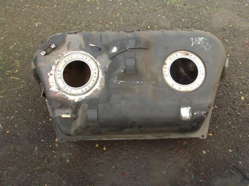

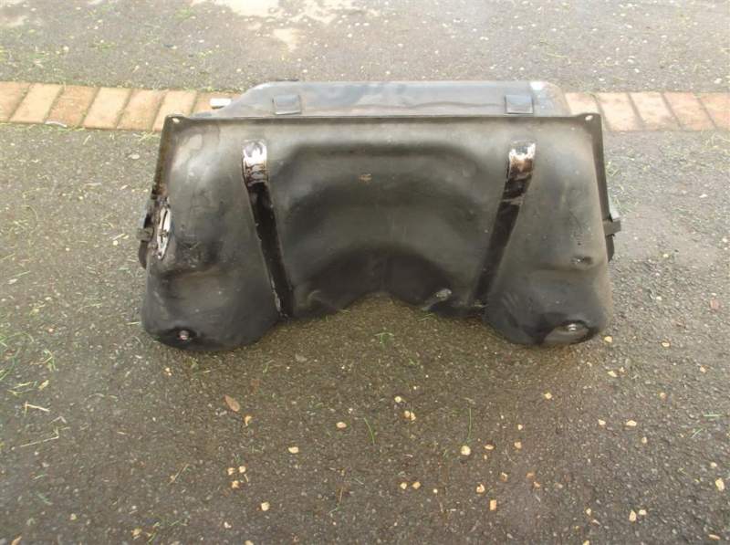

We have decided to reduce the size of the fuel tank to help reduce /eliminate fuel surge.
The SWB tank is an interesting saddle design and lends its self to being cut in half!!
One of my tame fabricators has got the job.

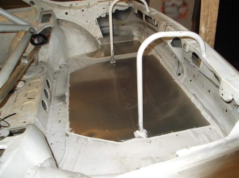

We decided that a flat boot floor would have several benefits including a small weight saving.
The main benefits are improved appearance and the emergence of a tidy area to install the fire extinguisher and NOS bottle.
The battery is moving over from the right rear corner to behind the pass seat area. Less cable so better performance and coupled with all the fuel on the same side the L to R weight distribution should be better once the driver is in.

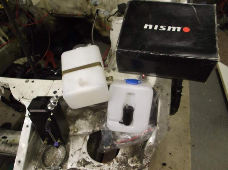

Up front I have ordered a trio of new bottles for fluids. These will all be mounted in visible positions instead of hiding under wings etc.

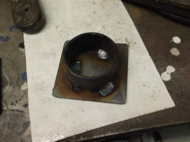

The car is now difficult to jack up quickly as its pretty low so Im am getting new jacking points welded in to facilitate a one step jack up with a low entry racing jack. Hopefully this will end the damage to the sills.

On the fuel tank, I think it's an interesting idea, my concern would be having it off centre will mean your diagonal weights will change with fuel level which could impact the handling
Keep the updates coming :)
With the standard tank on hard corners most of the fuel rushes to one side or another anyway. IMO this will actually make it more predictable as all the weight will be on the left side. This balanced out by the fact that on track there is usually only me. On the right side :)
In practice I dont think the change wil be "significant. Remember we dont have an F1 driver at the wheel :whistling:
We are hoping to run with a much lighter fuel load at all times.

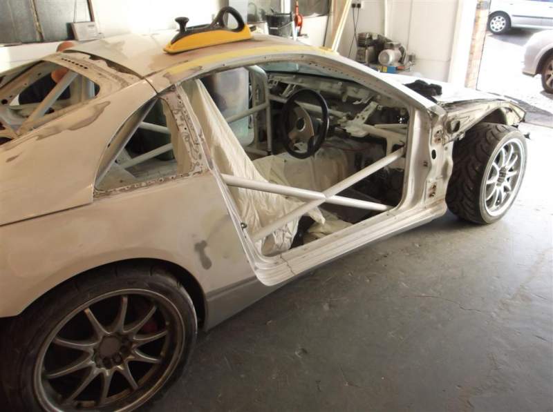

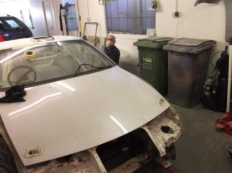

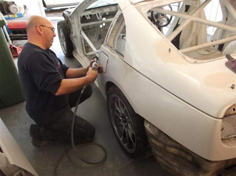

So today I popped in to Bodymech to check up that they were working.....................
Well Boldy was at least.
Darren was also but ran away when the camera appeared!!.
Allan was just uncovering some pretty horrendous "accident damage repairs!!!

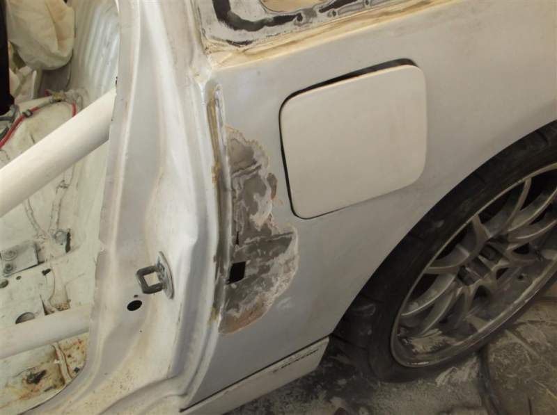

Paint can hide a number of sins!
I didn't think my sills were too bad until I had them done! There was more filler than metal hidden under the paintwork!!
You want to see it now! Lol!:whistling:
Bigger holes appearing but nowt Al won't sort.

I could see there was some dodgy filler work there but i was quite suprised to find what it was hiding !
After a bit more digging
[ATTACH=CONFIG]75358[/ATTACH]
The quarter was sat in a fair bit to the door so i cut out the plate that had been welded into give me more access to get the slide hammer in and used wiggly wire to pull the top section back out and pin pulled the dints .
