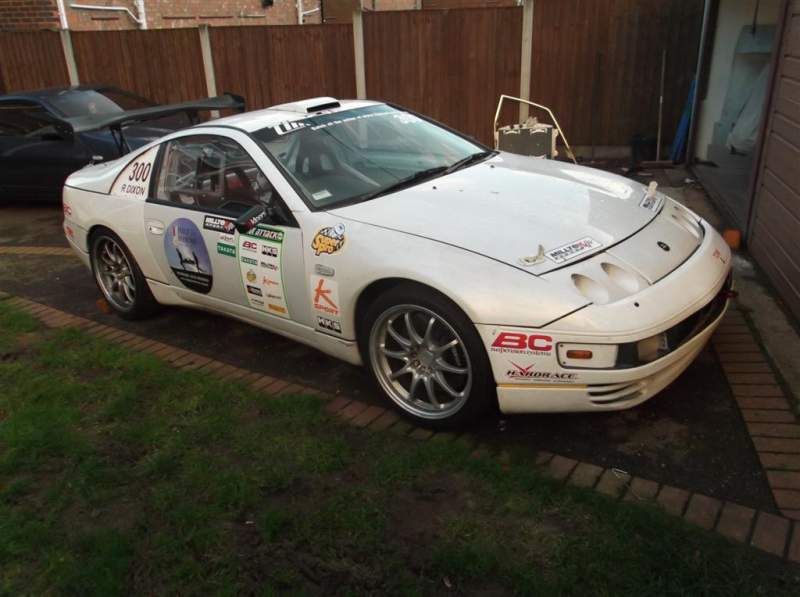

After a hard but fairly successful season of events Bob has dropped the car off with me for a major makeover and revision.
As before I just have the rolling shell.
Jimmer at Power Zed has already removed the engine and box.
He will be doing a strip down /inspect/replace routine on the Kyle Puckett engine.
Bob has dropped the gearbox of at Advanced Motorsport engineering at silverstone for a similar strip/inspect/replace routine.
The rest arrived at my place last weekend .... looking a little worse than when it left in the spring!!!!
The brief from Bob is long and detailed.................. but it starts with a reinstate of the 99 spec front with splitter and the TwinZ rear bumper.
I already obtained a good used 99 spec from Mikey Bean and I have a new Twinz rear from Mark Derbys group buy.
I will get a new sheet of ally and make another front splitter. good job I kept the template!!
There are numerous detail improvements on the schedule too. More details to follow!

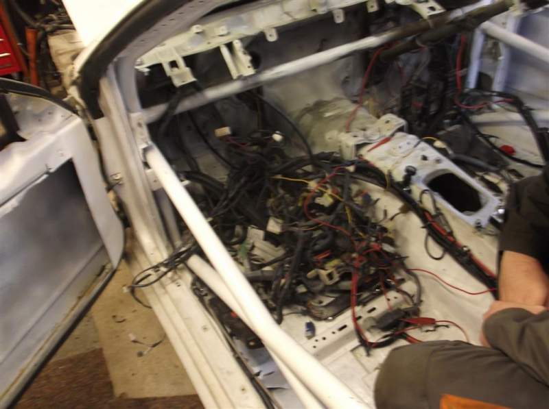

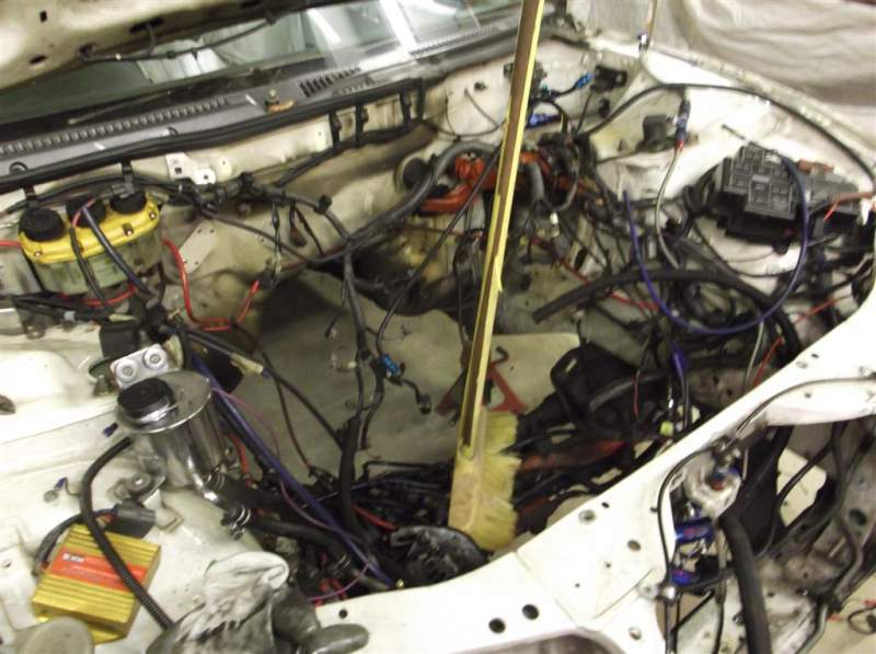

Probably the most important/significant is a new custom loom for the car. Over the development period of the car numerous items have been added by several people. The result now is a total mess of wiring everywhere with no one personknowing exavtly what is joined to what!!!

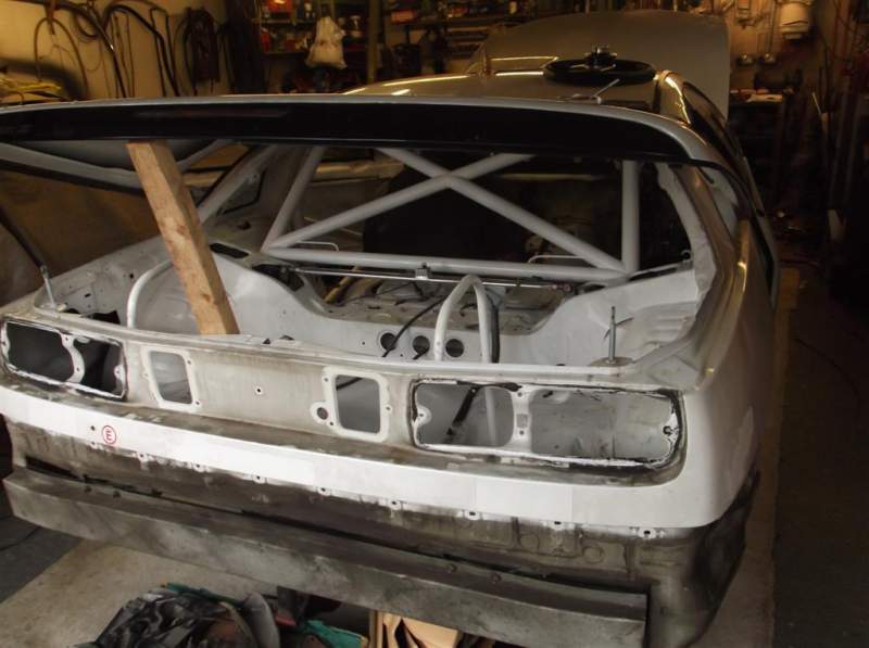

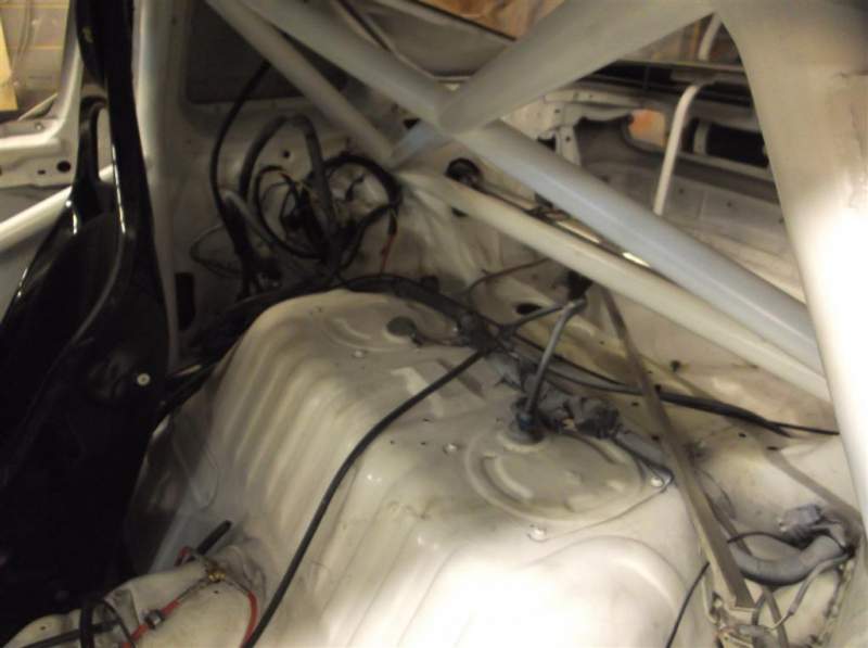

So a few pics meantime and can you spot the brake problem???
I have also highlighted some fittings that need "improving"
Check out the rats nest of wiring too!!

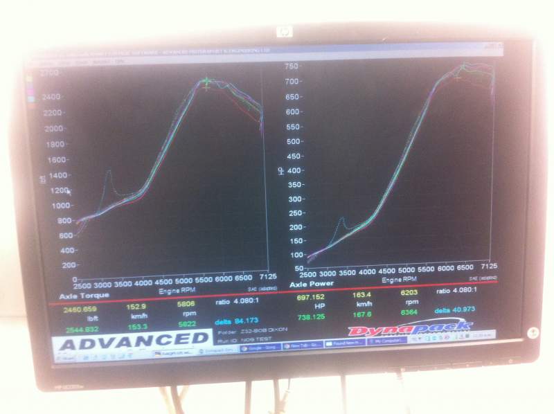

Hope you do Japshow today, sure it will surprise a lot of people. I make it 624ftlb and 738 hp, can you confirm these are hub figures and I'll update the dyno thread :)
These are at the hubs James. We should get a bit more out of it yet as we were getting tired and at 2 am we were waking up the neighbours lol. Plus when we install the Infiniti and turn on the NOS I'm hoping for a lot less lag but we shall see.
Is that little blue shark's fin at low rpm wheelspin or a glitch or something?
From previous runs :)

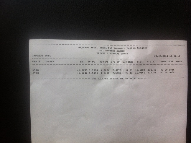

Here's the print out from my two runs today at Japshow. I did three actually but they didn't register the third run which I believe was an 11.5. Just 6 hundredths off the 10 second but I am really happy with my 60 foot time and if I can maintain that 60 foot will easily hit the 10 second mark So at TOTB I will most likely remove the front splitter and the rear spoiler. I also left a pair of 265 tyres on the front so will change them for a pair of 235 and I hope that will be enough to get the time down.
Excellent 60ft time, what tires are you using for that?
Hoosier road legal. Worked really well today and I'm hoping they stay sticky for TOTB. I managed to break traction on my last run so will have a good look at them next week to see if they're still good.
