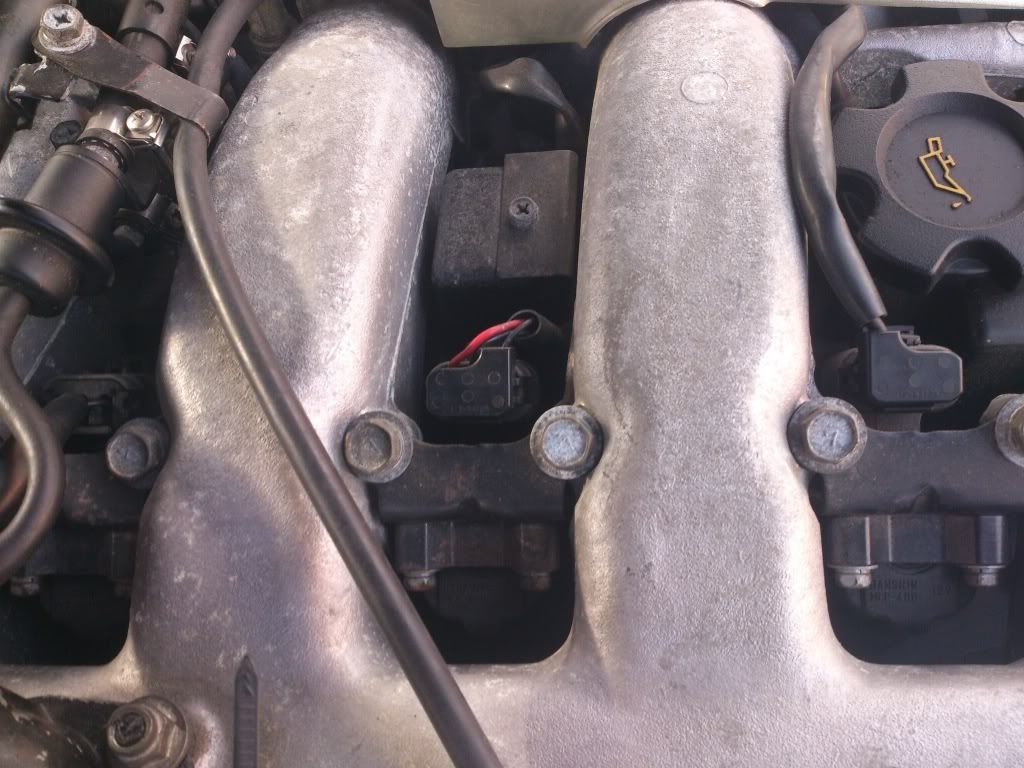

Cheers for the link, yeah that does sound exactly the same. These are the state of my connectors, They all appear to look different, so which is good and which is not?
And is there a way of finding which connector is causing the misfire?
Your coil pack connectors are made up of a main body, a cable separator and a top.
In your upper picture the left hand connector has both the top and cable separator is missing, the right hand connector is just missing the top piece.
In your lower picture the right hand two connectors in the lower picture are intact, the left hand one has the top missing.
Non of the missing parts is a problem, providing all of the connectors are a snug fit and not loose then the next place to check is the ptu connections, the unit has two large connectors the main one to check is the lower left hand one as this tends to go a bit green, with the engine running rock the connector and see if the engine changes, WD40 and a craft knife or similar is all you need to clean them.
