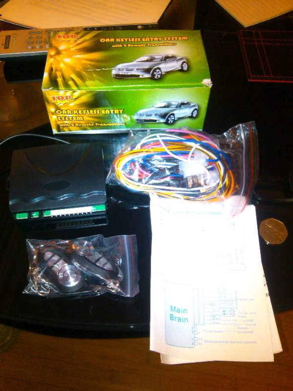

What kit did you buy? Does it have everything you are gonna need? (once you buy an actuator)
its just a cheap ebay jobby one. its got everything else required in the box(hopefully).
just ordered a actuator, much cheaper than i was expecting too. :-).
