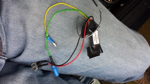

Do you have a picture of how the gauges are wired for the MPH / KPH converter, might have a touching wire on something else.

I'll have to take the cluster out and have a look. I'll put some pics up once it's out.
I would remove the mph convertor and see if your speedo problems go away. Your idle could be down to a faulty or blocked IACV and or incorrrect TPS/idle adjustment, does the car idle around 750rpm once up to temp?

Im sure I've read something similar caused by the mph converter. Try removing that first like has already been said.

Removed this little box of tricks
All the needle jumping has stopped. excellent.
