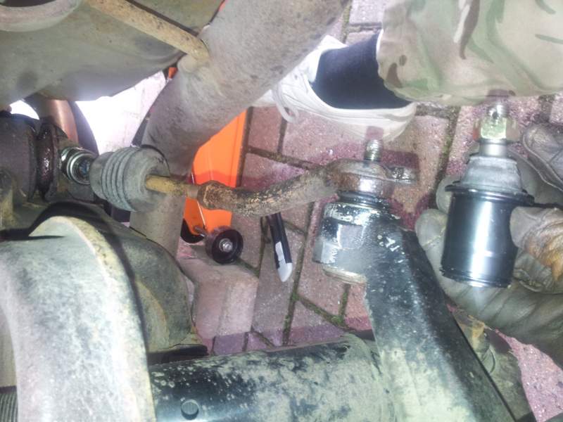

help please, I'm stuck. Hicas bush.
I have that new bush to go in, I have gt85'd and wire brushed the hell out of the end of the arm, finally got the nut off and stuff but can not move the arm off the bush.
I exposed the inboard end of the arm but don't want to dismantle things I don't need to. Does it just need a bloody good pull. Then there is the matter of getting the bush out of the hub.

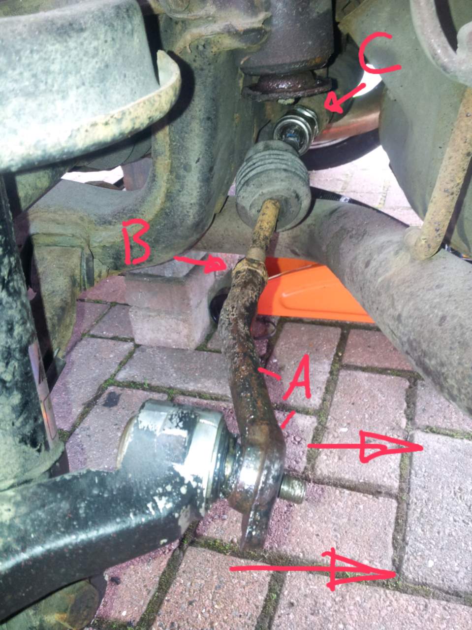

Have I missed something obvious here.
A will not go right, not with all my strength I have pulled muscles trying.
I have loosened B, to no avail.
Do I need to take it off at C?

don't know... some are luckier than other...
my mechanic had to take the whole assemble off (from C) and put it in/on a vice...
Cheers medallion man, well I've had a cup of tea and a chocolate bar, I'm angry and I have two big stillsons, that assembly is coming off.
I just bent the toe arm trying to push it off with a scissor jack :headvswal

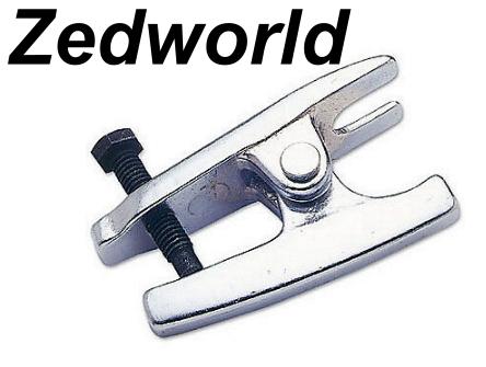

Ball joint splitter from Halfords or similar, 20 second job with one of these, they do go with a little bang though so don`t have your face too close.

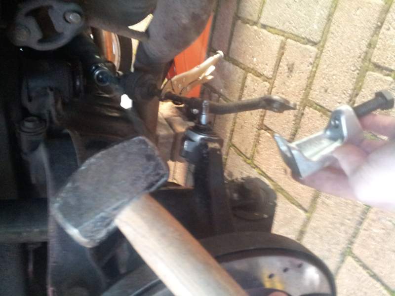

If they are anything like mine were, the bl**dy hammer won. (or a combination of the two?)

Yeah the hammer worked. And I gave the inboard end a good jiggle about and it seemed solid. Even if it didn't need replacing it bloody well does now lol. I stopped when it got dark, tomorrow I'm gona take the whole hub off and take it down to a garage for them to press it out. There is no room to get any good force on it and I can't pull on the nackered threaded bar.
