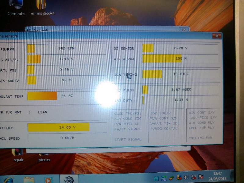

can anyone tell me what all the gauges should be reading on conzult when i plug my car in?

I've been after a hard and fast list of what things should show but I don't think there is one lol.
Fr example, the TPS, some say .46, others say .45 or .44. But the manual there says .4 - .5
Just a bit confusing I guess

All analogue sensors have an acceptable range. For example, it doesn't matter at all if the TPS is set to 0.44v or 0.46v at idle. The important thing with that particular sensor is the idle switch and the full range voltage output (eg 0-5v) in order that the acceleration enrichment is calculated correctly from the change in TPS voltage.
