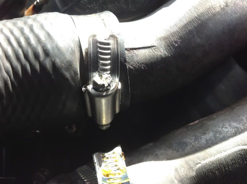

Thanks for the info mate, I didn't know that. I always thought they were better than jubilee clips. But I can't deny that with the jubilee clip not having changed since they were invented years and years ago, they must be more than up to the job. I think the biggest problem is that a lot of people just reuse old rusty ones that are past their best. I'm guilty of that (not on the zed though!) and I've also tightened them to far and broken them.
jubilee make a high torque version as well which can tightened to 17nm which is a fer nominal amount

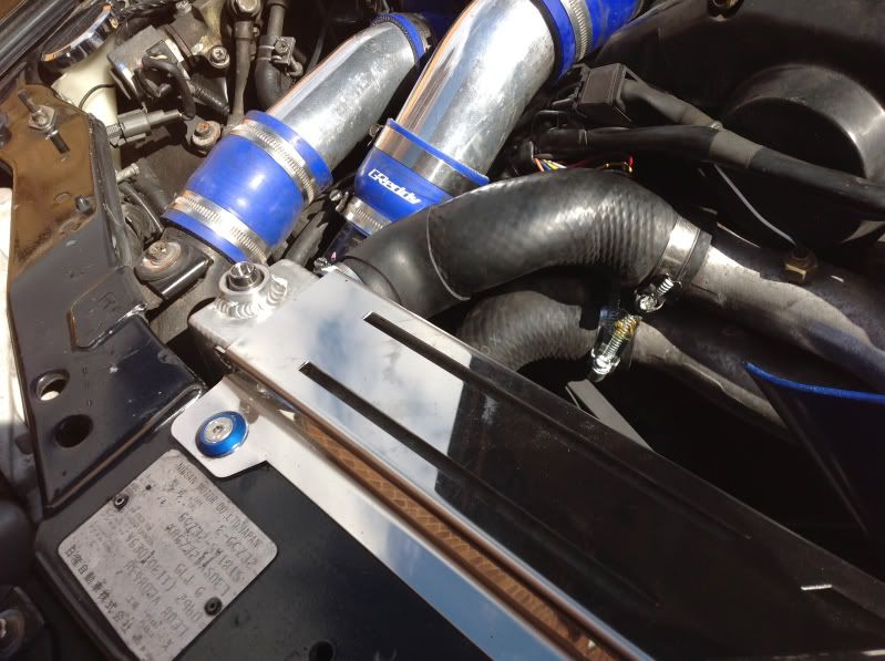

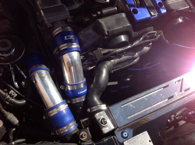

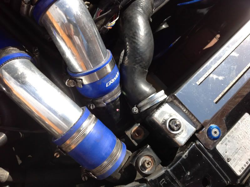

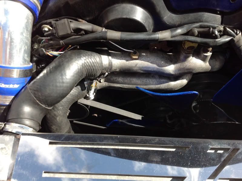

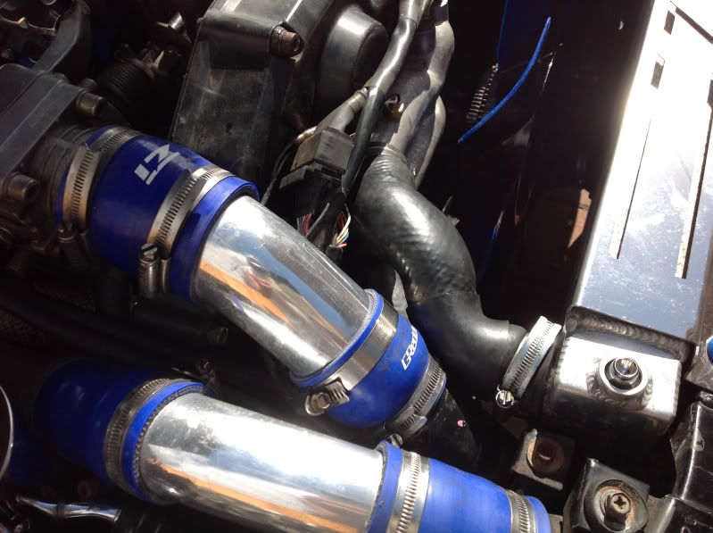

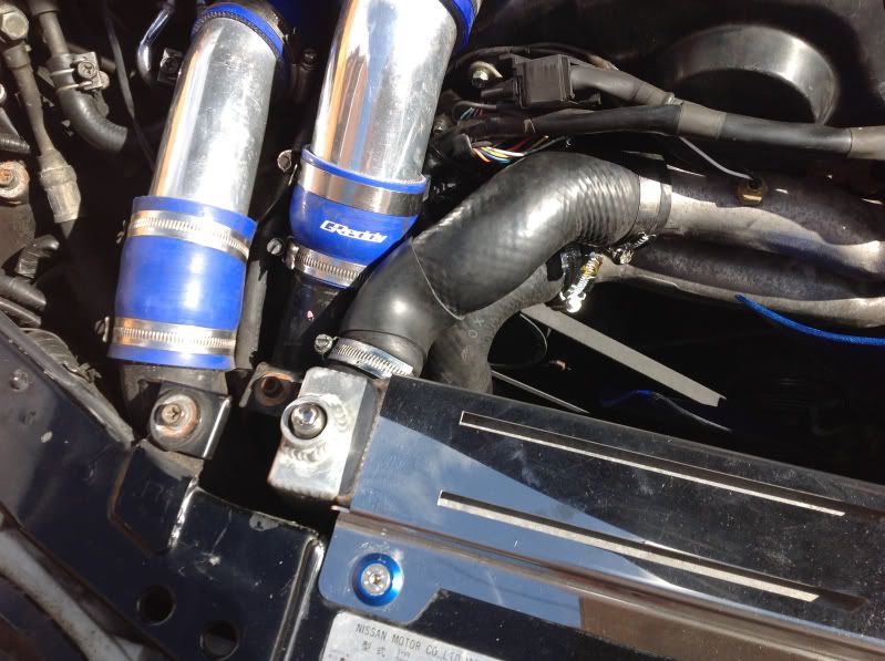

id trim the engine side and it will correct the angle on the rad side only out a small amount although pics are deceiving and put new clips on :)

The clips I've put on are ones I've found but they tightened more than any others

honestly try to new jubilees use a torque wrench and clean the inside of the hose as well if theres rubbish in it you will never get a seal
Cool. Well drain the rad again, cut it down a little and get a couple of new clips

Thanks mate, ill get it drained at some point this week and take a small bit off and see how it goes

How much do you think I need to cut off? Half a cm?

only if they sell genuine jubilee clips not generic ones that look like them as those are the cause of most boost and water leaks as they arnt the real thing and are cheap and well not suited to cars in general if im honest
