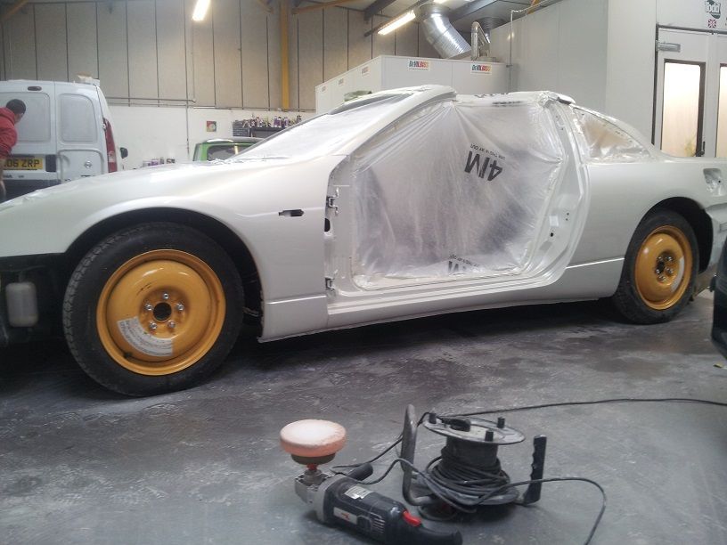

I stripped my car myself before it went for paint and I took the windows out completely.
