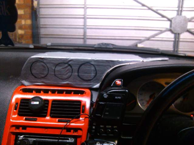

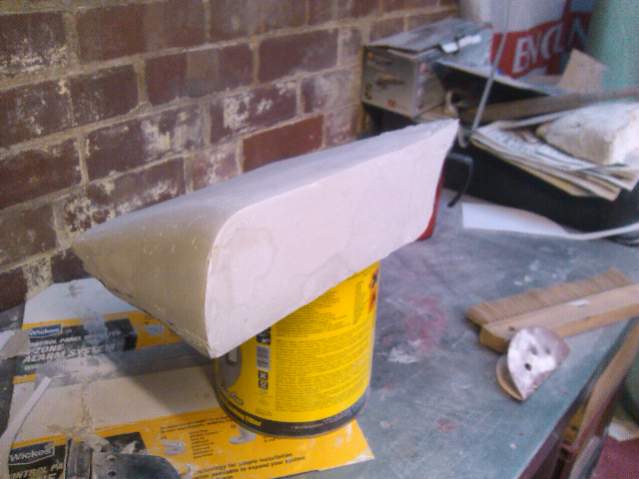

firstly i needed something to form a shape so i started cutting out some cardboard and covered it in lots of tape.

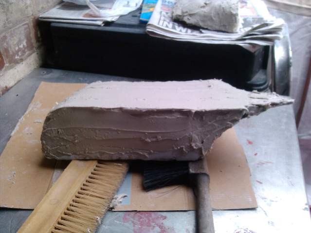

then i had to make it into a solidish shape, so i glued together some florist foam and shaped it out and plenty of filler.
then lots of sanding
After this i stripped down a original cluster cowl and started on making two become one.
lots of filler and many hours sanding and shaping later i had something that looked like this

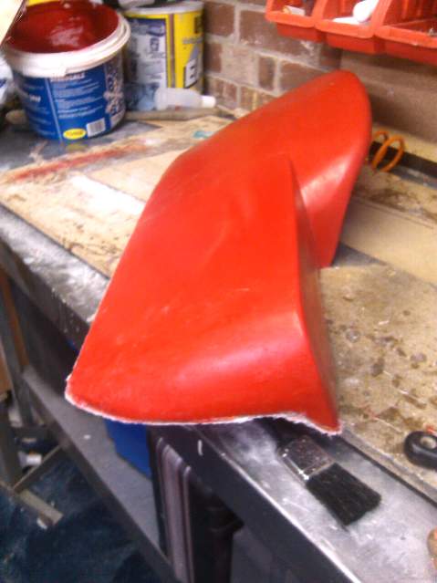

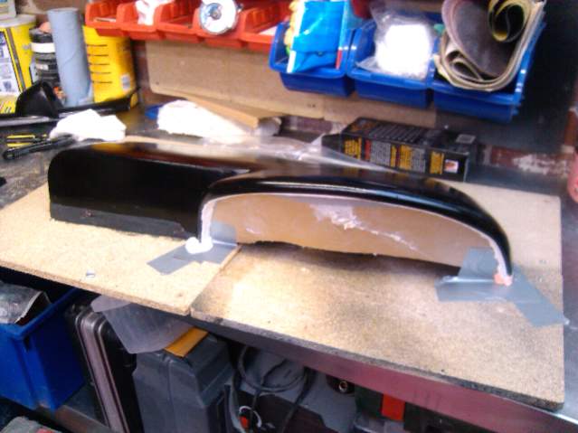

I then got it all painted up and ready to make a mold of it.
Edited by davezx
Great work Dave, nice to see you getting some enthusiasm back after the problems in the past youve had with her.
So now its time to get the sticky stuff out and do lots of fibreglassing.

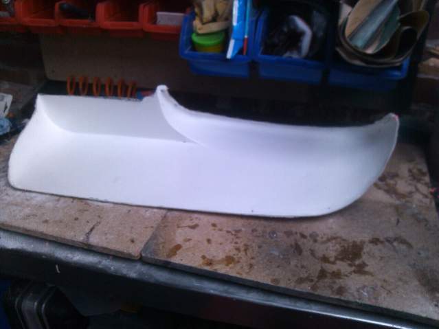

unfortunatley the original smashed to peices getting it out but after some persuasion it came out.
Then cleaned it up

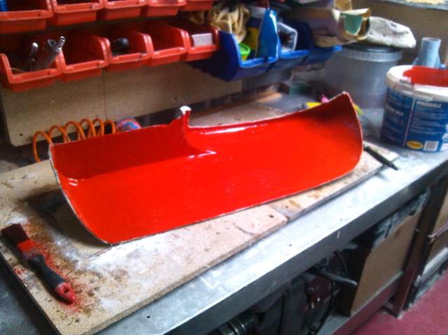

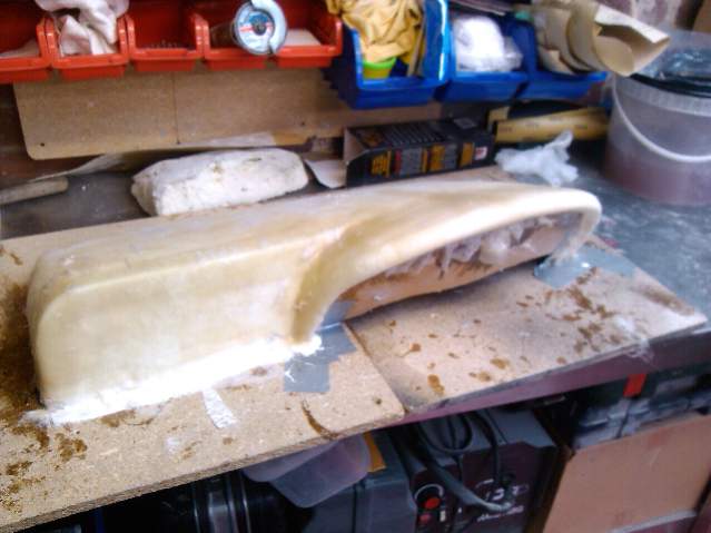

lots of mold release agent rubbed on to help the next stage and then some more fibreglassing
Next stage was to make sure that this time it didn't break seperating the two. that bit wasn't easy.

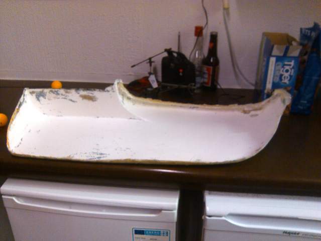

After some shaping and cleaning i was left with this.

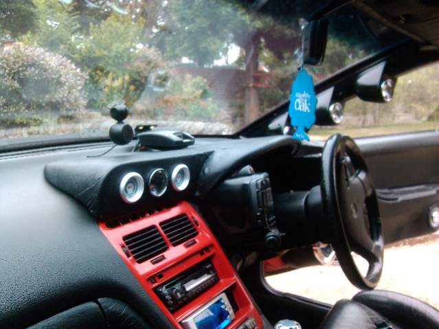

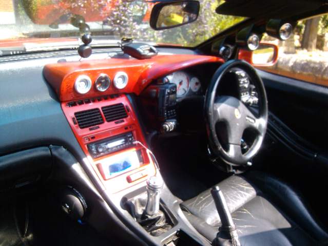

Then i trimmed it up with some leatherette(gonna be professionally done one day) and i am happy to have it all fitted now looking like this
This took some doing for me as i had never attempted anything like it before so im happy it hasn't turned out too badly.

Fair play to you, deciding you want something and then going at it yourself! :bow::bow:
Not my flavour Dave but mucho respect for the time you have put into it mate:bow::bow:
You know, i would be inclined to go a bit further with your design and recess the gauges and you have room for a couple of nice switches.
You know' date=' i would be inclined to go a bit further with your design and recess the gauges and you have room for a couple of nice switches.[/quote']
yi have thought of doing a mk2 version
but wont be until winter time when i take it back off the road.
