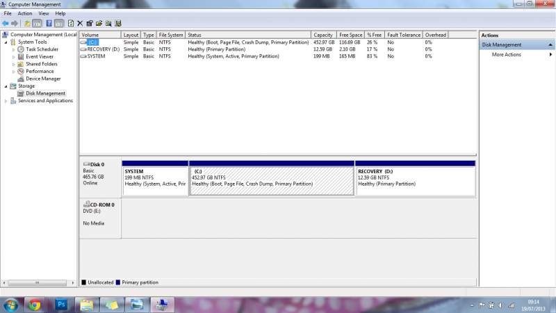

right click My Computer, select Manage, once its opens(it take a while depending on machine) select storage and then select disk management, it will show what hdd you have connect internally or externally. if theres an issue it will show or say un allocated or have a black bar cant remember but have a check, if not try updating the port its connected to if that doesnt try new cables docking station are bit a an ache bt if u cant get another hdd housing give it a shot. if all else fails google for some data recovery software.
hope its helps, and u get ur data back
Its a Mac hes trying it on.

[ATTACH=CONFIG]71934[/ATTACH]
