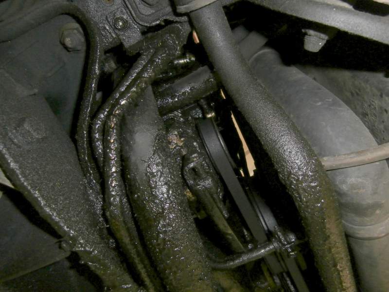

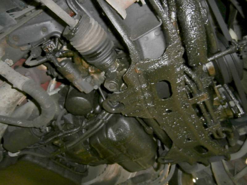

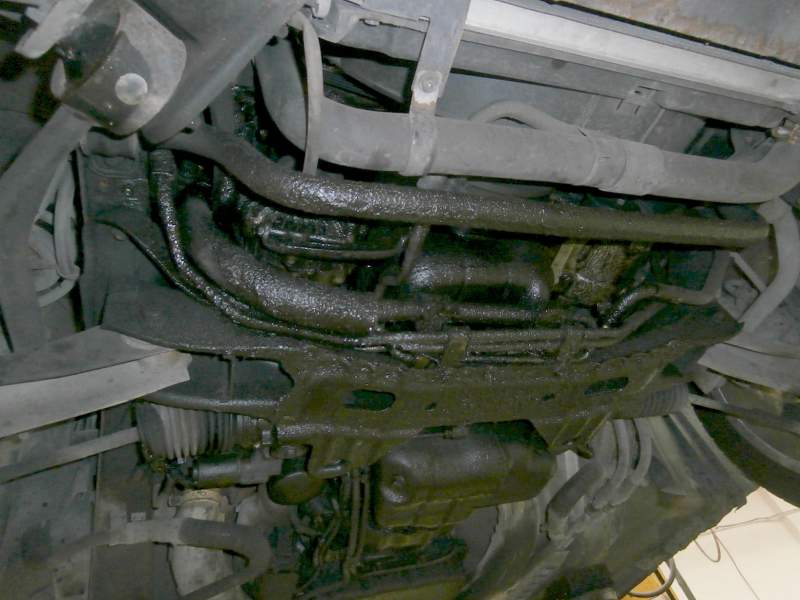

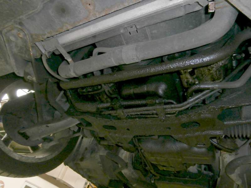

As luck would have it a zed in the workshop last week was in dire need of cam seals so took some pics.
Here are some of the underside
Look horrible and trust me flipping mucky to work on!!
continue..............

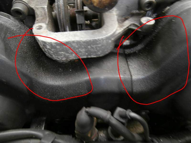

The tell tail signs at the cam covers leak can be at either end or just the middle or all three as in this case, the amount of oil that get flicks about can be quite conciderable.
The inside of the right hand cam belt cover shows how oily it was inside

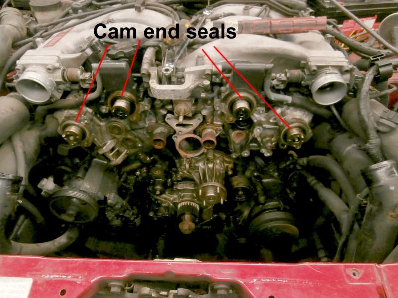

Unfortunately quite a strip down to get to as the cam sprockets need removing as ell as the back plates and then all need cleaning of course.

Thats rust prevention Jeff,and saves oil changes the constant top ups do the trick !!
Yes cool, shame that non sprayed on his radiator cross member then eh!!
Jeff
