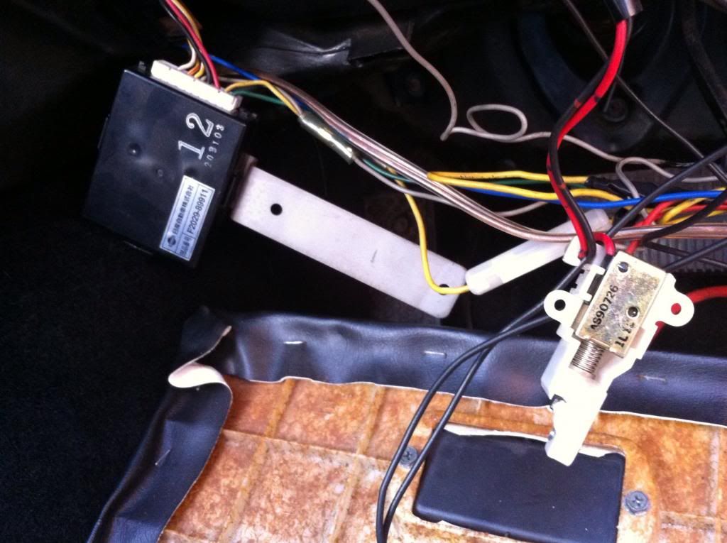

Asked this previously but didn't get a definitive response....now I've learned to post pics in a thread to show what I'm on about, I'll throw it out there again.....
Dropped the lower dash trim under the steering wheel the other week and found 2 things dangling behind it that clearly shouldn't be dangling there! One is a black box with a number 12 on it, the other is a white springy/contact sort of connection; both shown in pics below......

Thanks Mark. The release works, so it may have been swapped at some stage. The ignition key and door key don't match, but the ignition key fits the boot and passenger door, so I initially presumed the drivers lock had been swapped. I tried googling that part number Tom, but was none the wiser what a neon control pole was, if that was it....

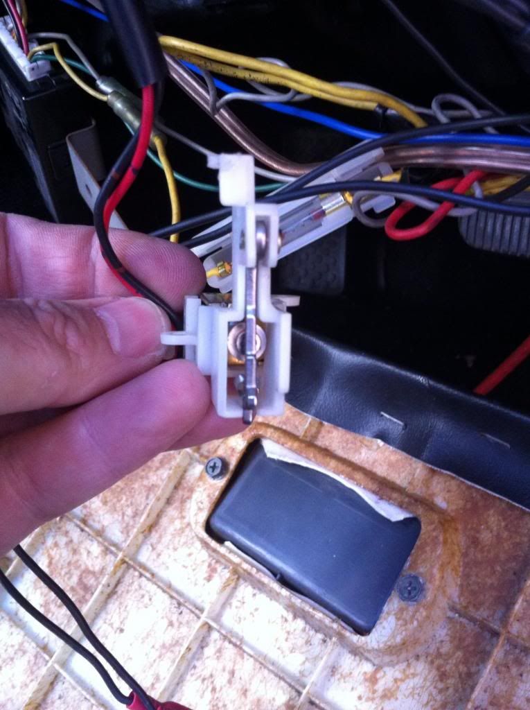

that white box is the Release key mech from the steering collum
Just to clarify m8, is this related to the button to release the ignition key or something to do with the steering lock? Haven't ever tested to see if steering lock works tbh...
Could be the valet key. Will open all locks but not start the car or open the glovebox, so that when its left to be cleaned they can access but niot drive it.
it locked the button/key in place when the ignition is on .... button just below the key ...
with it removed you can take your key out if you have a turbo timer install
other wise you can not get the key out ( ignition on ) for the duration of the timer
I thought that at first m8, but it driver door key will only open drivers door, nothing else. The 'ignition' key is red. This won't open drivers door but will open passenger door, and bobs work ignition. It won't do the glovebox though, as wont the driver door key....
No.12 black box....Jeff removed the same from my SWB a couple of weeks ago when converting to Manual. He informed me that Jap cars had parking sensors on the front bumper and a small ariel used to protrude from the front bumper when a small switch behind the gear leaver/Mirror switch was pressed.

looks like a motion detection device for the alarm ?
Ur right Wes, it does. That's what I thought it prob was when I found it, but its Nissan branded and the car doesn't have a factory alarm, it has a GT Thatcham one......unless its had a factory and been bypassed/disabled......
